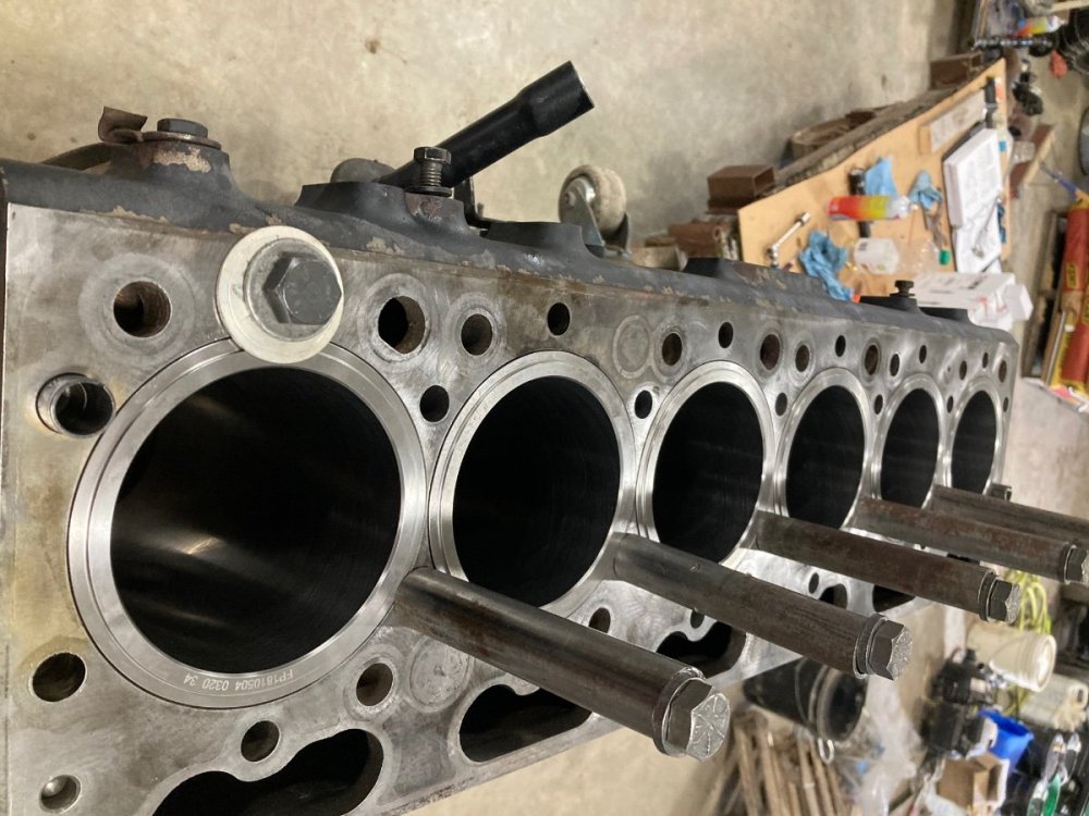

nate Posted April 3, 2022 Author Share Posted April 3, 2022 Cam bearings are in, crank is in and liners are installed. Sleeve protrusion is good and main bearings plastigauged good. 3 Quote Link to comment Share on other sites More sharing options...
bitty Posted April 3, 2022 Share Posted April 3, 2022 On 3/23/2022 at 9:52 PM, nate said: He went with FP diesel kit, Part of the Federal mogul company. Hopefully it is good. Where did he get his kit from? Quote Link to comment Share on other sites More sharing options...
89vmax Posted April 3, 2022 Share Posted April 3, 2022 U can tell this isn't your first go at an eng rebuild Quote Link to comment Share on other sites More sharing options...
nate Posted April 3, 2022 Author Share Posted April 3, 2022 11 minutes ago, bitty said: Where did he get his kit from? Might be your neighbor bitty? It came from Pennsylvania. I can check when I go to the farm today. Quote Link to comment Share on other sites More sharing options...
acem Posted April 3, 2022 Share Posted April 3, 2022 Where were the parts made? How do they look? Quote Link to comment Share on other sites More sharing options...
bitty Posted April 3, 2022 Share Posted April 3, 2022 2 hours ago, nate said: Might be your neighbor bitty? It came from Pennsylvania. I can check when I go to the farm today. Probably Jessie at tractor restoration sales. He is having a sale in a few weeks and moving to another location Quote Link to comment Share on other sites More sharing options...
nate Posted April 4, 2022 Author Share Posted April 4, 2022 8 hours ago, bitty said: Probably Jessie at tractor restoration sales. He is having a sale in a few weeks and moving to another location That was it. Quote Link to comment Share on other sites More sharing options...
