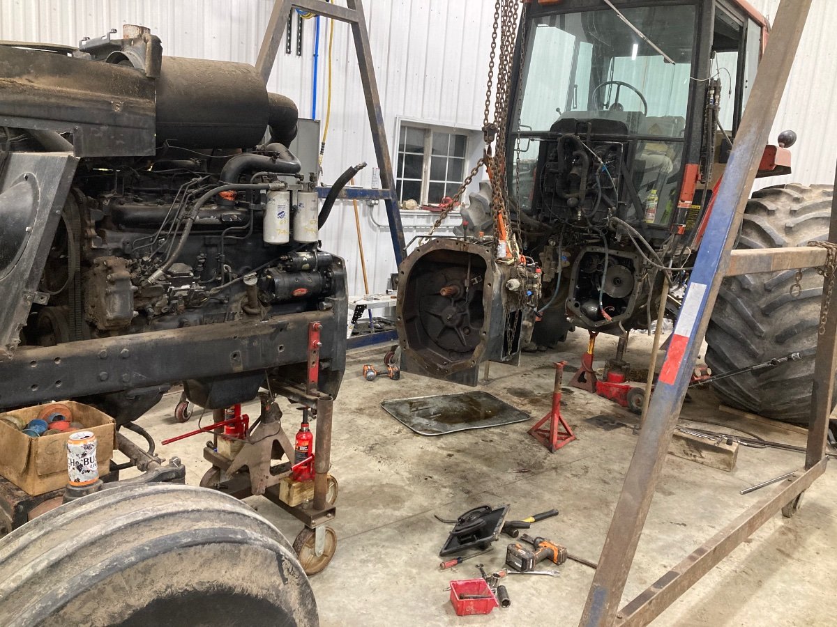

nate Posted February 22, 2022 Share Posted February 22, 2022 So my brothers tractor had trans issues so we tore into it. Was hoping to not have to use the 88series service tools I picked up a while ago but here we are. First 88 series we have been into. 5 Quote Link to comment Share on other sites More sharing options...

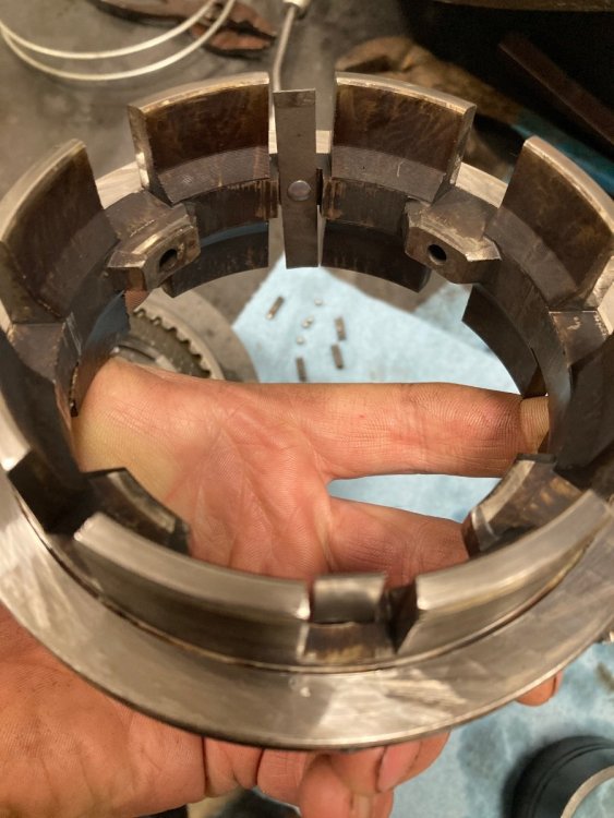

nate Posted February 22, 2022 Author Share Posted February 22, 2022 Chipped gear, disks worn into constant mesh, speed disks smoked, speed input shaft galled 4 1 Quote Link to comment Share on other sites More sharing options...

nate Posted February 22, 2022 Author Share Posted February 22, 2022 More junk. We decided we were this far that we would check out the range. Pulled it out and took apart synchros and they were bad. 1 2 Quote Link to comment Share on other sites More sharing options...
