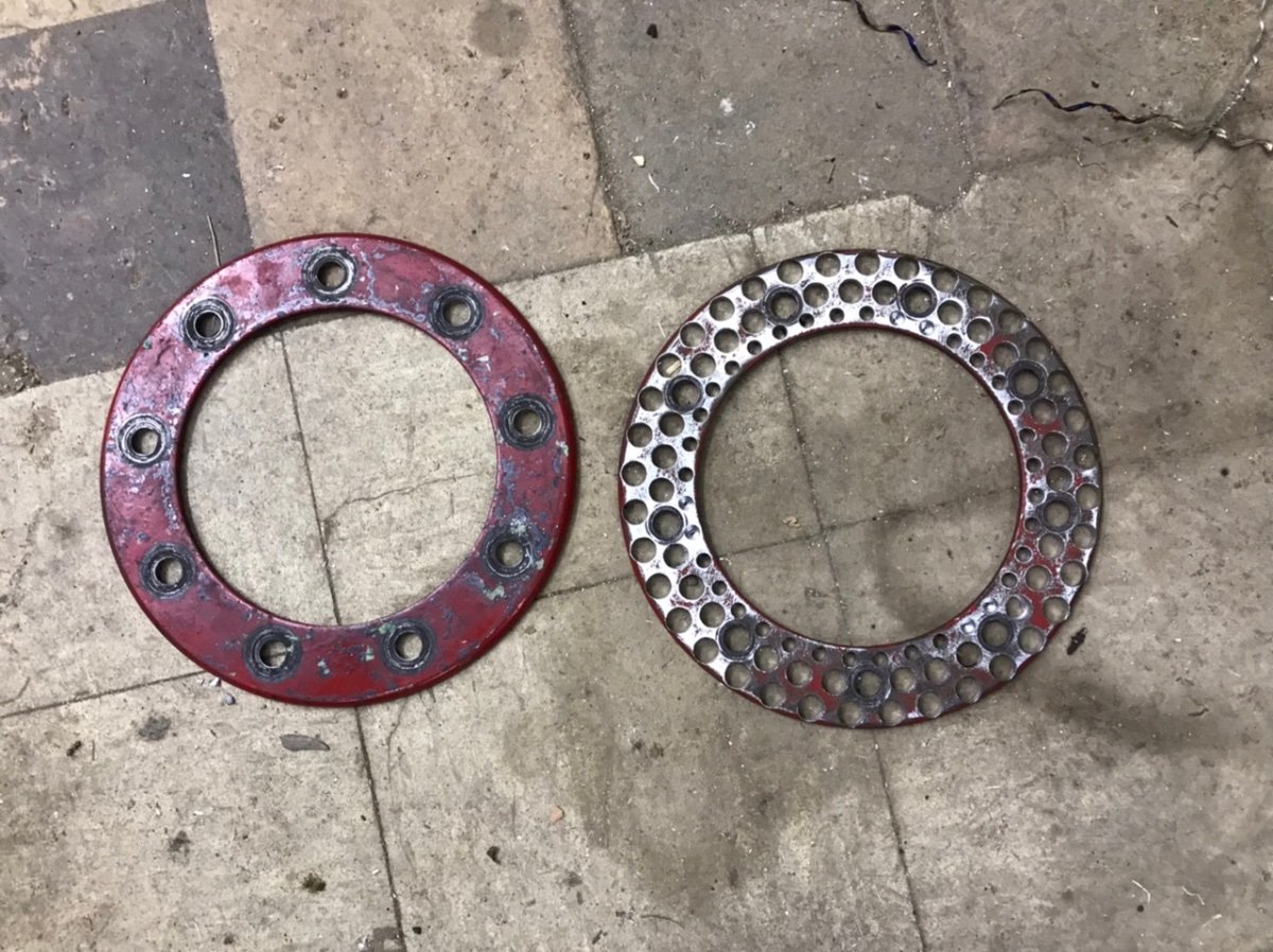

twood1954 Posted January 8, 2022 Share Posted January 8, 2022 After much discussion it was determined that either the tractor or the driver had to go on diet so would have more front-end weight. It seemed easier for the tractor to lose weight. New cage should be 100 lbs. lighter. Gun drilling axles and drilled brake rotors should lose over 250 lbs. Sorry for pictures being sideways. I can't seem to get the right way. 9 Quote Link to comment Share on other sites More sharing options...
Brockpend Posted January 8, 2022 Share Posted January 8, 2022 Looks good! Quote Link to comment Share on other sites More sharing options...
m.c.farmerboy Posted January 14, 2022 Share Posted January 14, 2022 That should work! Quote Link to comment Share on other sites More sharing options...

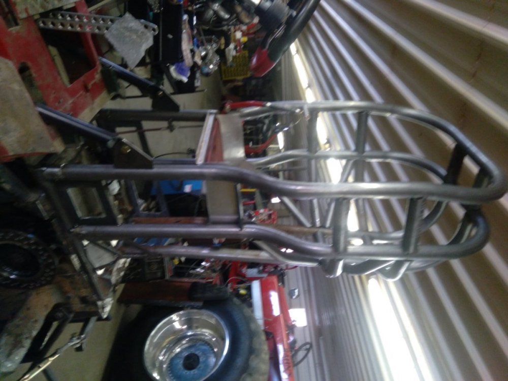

twood1954 Posted January 17, 2022 Author Share Posted January 17, 2022 Update on new cage project, a couple braces to tack in and then build new seat and weld and paint and it will be done. 4 Quote Link to comment Share on other sites More sharing options...
RAH Posted January 19, 2022 Share Posted January 19, 2022 Chrome moly cage? Old one mild steel? Quote Link to comment Share on other sites More sharing options...
twood1954 Posted January 19, 2022 Author Share Posted January 19, 2022 dom chrome moly was over $17 per foot if you can find it. Should still be over 100 lbs. ligther than old cage and in my opinon much stronger. Quote Link to comment Share on other sites More sharing options...
brahamfireman Posted January 20, 2022 Share Posted January 20, 2022 656 rear end? Quote Link to comment Share on other sites More sharing options...
twood1954 Posted January 20, 2022 Author Share Posted January 20, 2022 Yes 656 rear end. Quote Link to comment Share on other sites More sharing options...
Allen Ulmer Posted January 23, 2022 Share Posted January 23, 2022 That in The King’s shop? Looking good! Getting ready to cut a cage off myself! Quote Link to comment Share on other sites More sharing options...
twood1954 Posted January 24, 2022 Author Share Posted January 24, 2022 Yes the king's shop. 1 Quote Link to comment Share on other sites More sharing options...

twood1954 Posted February 1, 2022 Author Share Posted February 1, 2022 Update on cage. Just have to finish seat and d then take cage off tractor to weld up. Then grinding and painting starts. 1 Quote Link to comment Share on other sites More sharing options...
Allen Ulmer Posted February 1, 2022 Share Posted February 1, 2022 Looks good! Getting weight off of cast tractors is a huge undertaking! We had a 706 rear with 3 chargers, 10 ply 30.5 puller tires, etc down to 5100 with no driver! They have k a huge amount of hours (500+) to get it that light! 1 Quote Link to comment Share on other sites More sharing options...
twood1954 Posted February 1, 2022 Author Share Posted February 1, 2022 The tractor should weight around 5200 lbs. when done. Hoping to have 750 lbs. of moveable weight. Now need to have driver lose some weight. Quote Link to comment Share on other sites More sharing options...

twood1954 Posted February 14, 2022 Author Share Posted February 14, 2022 Started doing finish welding. Joel is an artist with welder. 3 Quote Link to comment Share on other sites More sharing options...
twood1954 Posted February 17, 2022 Author Share Posted February 17, 2022 Almost done. 5 Quote Link to comment Share on other sites More sharing options...
twood1954 Posted March 5, 2022 Author Share Posted March 5, 2022 Update, cage complete assembled, polished, primed and first coat of paint on. Second coat tomorrow and then it will be done. 4 Quote Link to comment Share on other sites More sharing options...
