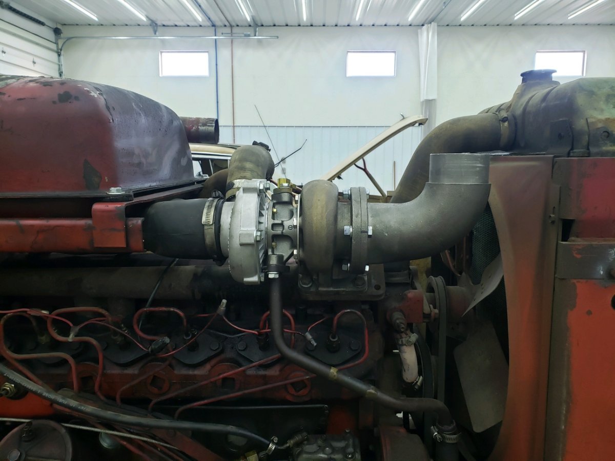

diesel digger Posted January 5, 2022 Share Posted January 5, 2022 I think original was garret A/R T606. Are there any other bolt on replacements? Or "close to bolt on replacements? Putting this on a 706. Anyone have pics of air cleaner setup and placement? For a factory add-on. Not an M&W. Thanks. Quote Link to comment Share on other sites More sharing options...
Nebraska1206 Posted January 5, 2022 Share Posted January 5, 2022 That setup will interfere with the current air cleaner on a 706, since its currently mounted right where that exhaust elbow would want to be. Not sure how you'd want to go about relocating the air cleaner, probably have to customize something. A 560 dry-type air cleaner was mounted on top of the hood, right in front of the operator, if that was added in addition to the turbo setup. Quote Link to comment Share on other sites More sharing options...
louie figone Posted January 6, 2022 Share Posted January 6, 2022 Spencer Diesel shows a turbo for the 560 (part # SDTTO4N8069) I don't know if this is a replacement or a conversion turbo, you might want to check it out. Quote Link to comment Share on other sites More sharing options...
Old-F20 Posted February 26, 2022 Share Posted February 26, 2022 I looked around and talked to quite a few people about the 606 garrett. you can find seals and bearings but thats it. if you damage an impeller or a housing then its a doorstop. I looked around for a while gathering info and ended up using a new turbo that is for an Allis Chalmers 190XT. for the most part it was a bolt on affair. It even used the same oil drain tube as the garrett. I plumbed a new pressure line because they old one had a spot that was rubbed thin. The exhaust elbow Needed to be re-indexed since the IH manifold sits at an angle to the ground and the AC manifold is flat. No big deal to re drill 4 holes. I did mine on a 560 but would be the same for a 706 minus the air filter housing 3 Quote Link to comment Share on other sites More sharing options...
