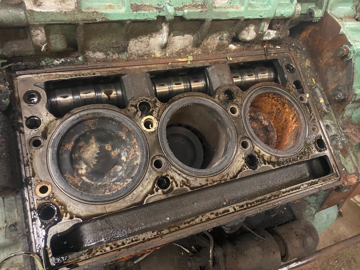

AngrySailor Posted January 3, 2022 Author Share Posted January 3, 2022 Steering and radius rods all done and working nicely, no interference or binding even at axle maximum angularity. Pulled the heads of just now. Left bank smoked when I hadn’t running years ago. It’s pretty rusty, right bank looks better but it’s all got to come apart. I’ll Put the best pistons and liners in, probably start a valve job soon too. 3 Quote Link to comment Share on other sites More sharing options...

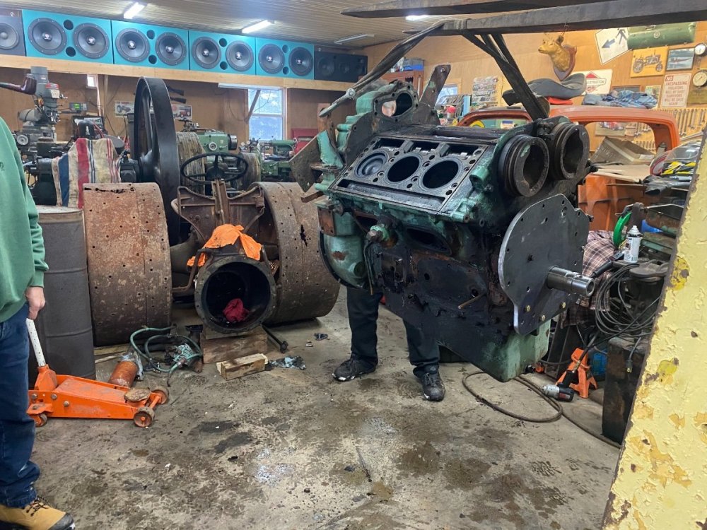

AngrySailor Posted January 7, 2022 Author Share Posted January 7, 2022 Been a bit busy last few days but back at the shop today. Spent the morning cleaning up and found an 11” Chevy clutch and pressure plate. Going to have to face the Detroit flywheel as the the step doesn’t allow the whole friction to make contact. No biggie, it’ll be “light weight”... pulling the motor off the tractor next and going to remove the pistons and liners hopefully this afternoon. Quote Link to comment Share on other sites More sharing options...

AngrySailor Posted January 7, 2022 Author Share Posted January 7, 2022 35 minutes ago, rustred said: this is what i was wondering about, how the connection was going to made made.,.. from engine to trans. Dry clutch and I’m going to splice a Chevy spline to the Fordson input shaft. Then there will be a coaxial floating sleeve surrounding the input shaft which the Fordson fork will act on to push the Chevy diaphragm. got the pistons out of the second engine now. Just have to drive a friend to town then I’ll be pulling the liners. Parts are the n at the truck shop for the engine. Should be here Monday or Tuesday. Didn’t even ask how much and I should have... a set of rings was $80/hole and gasket set was around $300... ouch... 1 Quote Link to comment Share on other sites More sharing options...
AngrySailor Posted January 7, 2022 Author Share Posted January 7, 2022 Liners out. Heat exchanger must have had a leak when this was in the boat, cooling jackets have a lot of sand in them... Quote Link to comment Share on other sites More sharing options...

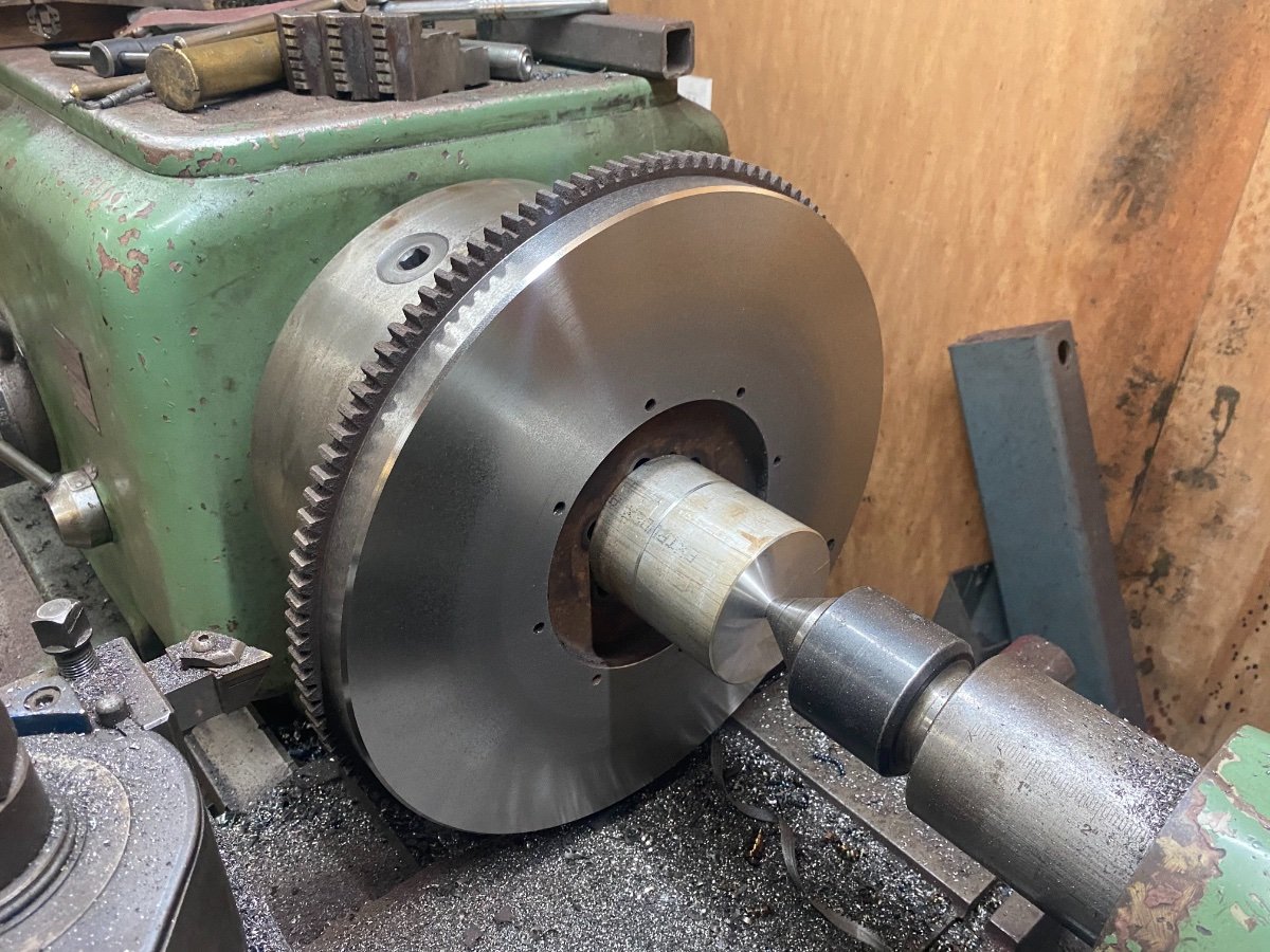

AngrySailor Posted January 8, 2022 Author Share Posted January 8, 2022 Flywheel machined, just need to index the clutch cover pattern and she’s done. Disc makes full contact now, clears the flywheel bolts too. Good to go. 4 Quote Link to comment Share on other sites More sharing options...

AngrySailor Posted January 8, 2022 Author Share Posted January 8, 2022 Been poking and vacuuming the water jackets on this thing. Left bank was plugged solid on the outboard side. Had to have been overheating. Got most of it cleaned up now. Ideally would pressure wash everything but I don’t want to disassemble the entire block to get the crank out. Trying to keep the bottom end bearings clean enough I can wash down with diesel then reassemble also want to leave the patina (dirt) on the outside as much as possible... Quote Link to comment Share on other sites More sharing options...

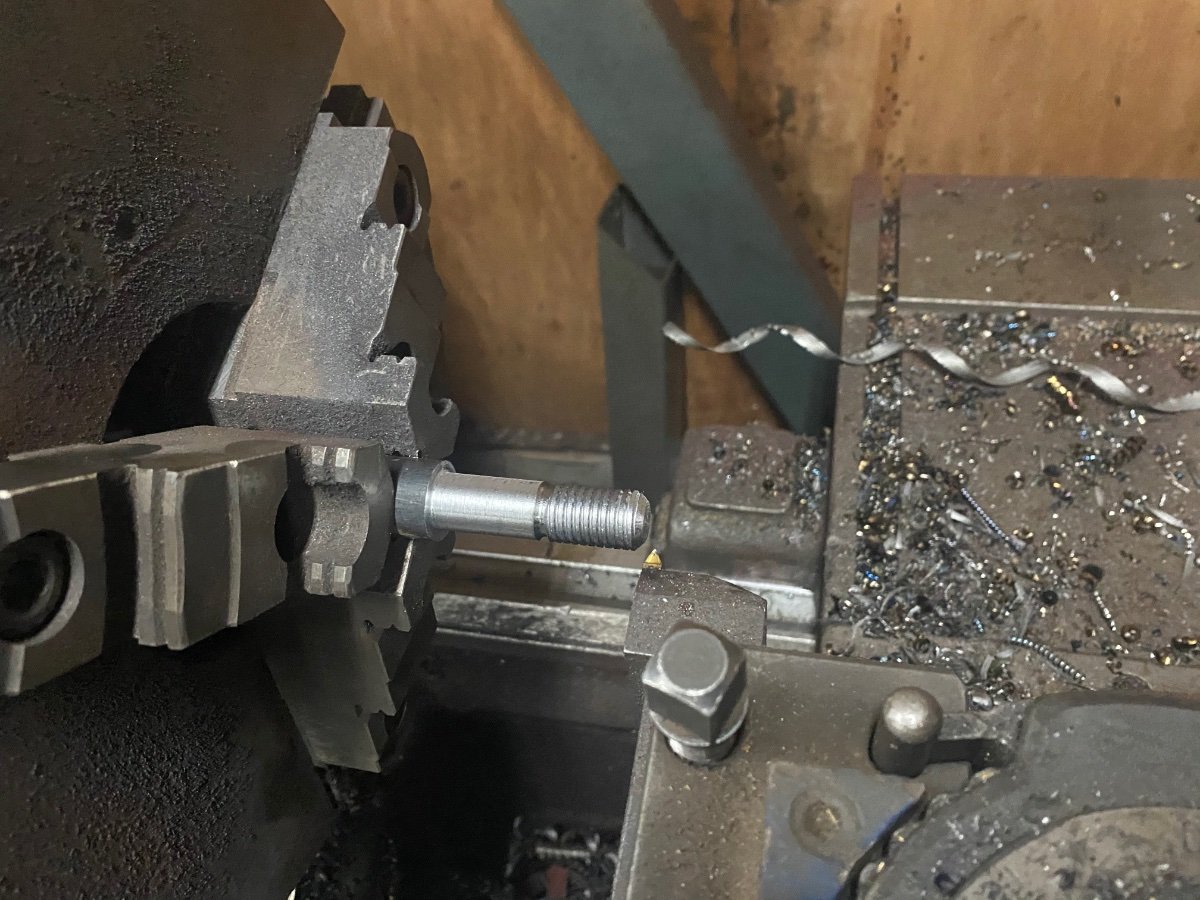

AngrySailor Posted January 8, 2022 Author Share Posted January 8, 2022 Eyeing up the input and throw out. Coming up a little short on length. Probably grab a scrap truck axle from the junk yard cuz alloy steel and splice it in. 2 Quote Link to comment Share on other sites More sharing options...
