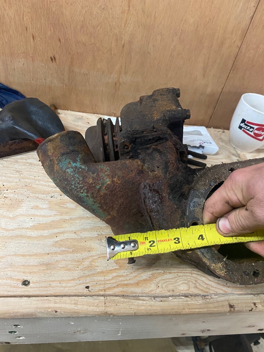

AngrySailor Posted December 22, 2021 Author Share Posted December 22, 2021 Working on the water inlet today. Going out now to pick up some fittings. Probably going to tack weld things with the TIG then braze to seal it up. 1 Quote Link to comment Share on other sites More sharing options...
AngrySailor Posted December 22, 2021 Author Share Posted December 22, 2021 Inlet relocated, tacked with TIG going to seal with braze. 3 Quote Link to comment Share on other sites More sharing options...
DT Fan Posted December 22, 2021 Share Posted December 22, 2021 Very impressive. 1 Quote Link to comment Share on other sites More sharing options...
AngrySailor Posted December 22, 2021 Author Share Posted December 22, 2021 (edited) Brazing done, test fit seems good! No guarantees on my welding/brazing work! Didn’t pressure test it but pretty sure there nothing some rust and a stop leak puck can’t handle! Edited December 22, 2021 by AngrySailor Wrong pic 1 Quote Link to comment Share on other sites More sharing options...
Rawleigh99 Posted December 22, 2021 Share Posted December 22, 2021 Is that tig brazed? I am going to order some wire and try MIG brazing myself 1 Quote Link to comment Share on other sites More sharing options...
AngrySailor Posted December 22, 2021 Author Share Posted December 22, 2021 19 minutes ago, Rawleigh99 said: Is that tig brazed? I am going to order some wire and try MIG brazing myself No, just oxy/acetylene. Never had the right filler to try TIG brazing... would probably make a neater job but hey, this is looking like it’s going to be a rat build so can’t get TOO fancy! For the patch plate I just flowed it with the TIG, no filler and peened it some, didn’t go for deep penetration and it probably would have been ok without any brass but there were some small stress cracks. Cast is a pain in the azz, I prefer cold repairs when at all possible. Repaired a 14” long crack in a 4hp IHC Famous with loc-n-stitch, man their stuff is worth every penny if you have an expensive/rare part to repair. Don’t even think of putting heat or weld to it or you’ll make hard zones and dink yourself for a future s titching repair! so far on this build I spent ~$25-30 on plumbing fittings today, everything else has been freebie/owe a friend a small favour so loc-n-stitch isn’t really in this builds budget! Would definitely cut into the builds beverage fund! 2 Quote Link to comment Share on other sites More sharing options...

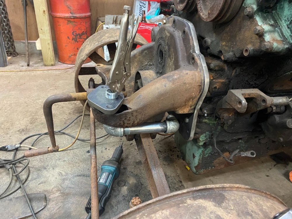

AngrySailor Posted December 22, 2021 Author Share Posted December 22, 2021 Lower rad tank repair plate/adapter in the works. Really didn’t deserve the boring head treatment but my big drill press that takes larger MT drills is 3 phase and none at the new shop rn also didn’t feel like putting the ~200lb 4 jaw chuck in the lathe for one 1 3/8” hole... The Fordson front plate was rusted out/frozen so this will seal the bottom of the rad tank and I’m going to bring the pipe fittings out the busted casting and mate them up to the ones going into the water pump. 2 Quote Link to comment Share on other sites More sharing options...
AngrySailor Posted December 23, 2021 Author Share Posted December 23, 2021 Blasted a hole down through the busted coolant passage, keep the elbow tight high and the pipe will clear the axle at full angularity, short rad hose between them and the inlet side will be done. Quote Link to comment Share on other sites More sharing options...
