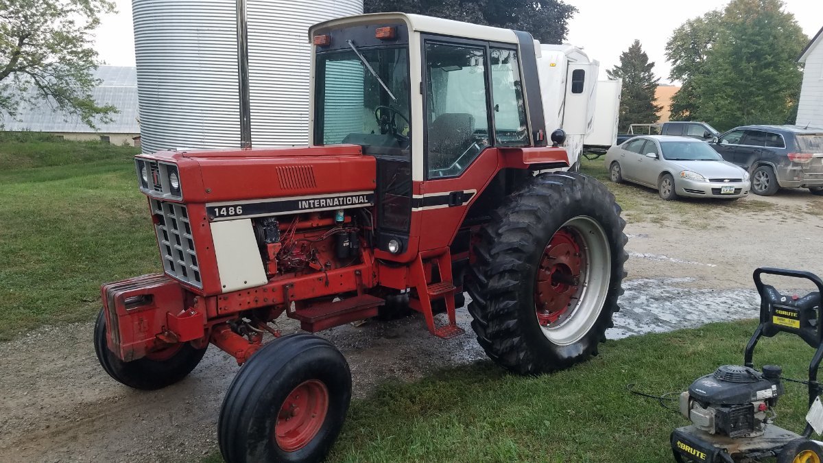

nepoweshiekfarmalls Posted November 15, 2021 Share Posted November 15, 2021 My 1486 has an eliminator. Cab is tight, exhaust stack is tall. Noise is minimal. Link to comment Share on other sites More sharing options...

801486 Posted November 16, 2021 Share Posted November 16, 2021 I have had a muffler eliminator on my 1486 for years no difference at all with doors on and doesn't bother me even in the summer when I take the doors off. My 1086 that has 1066 style exhaust and tin on that side is a different story it barks pretty good, gets a little annoying with the doors off. Link to comment Share on other sites More sharing options...

B.B. Posted November 16, 2021 Share Posted November 16, 2021 I didn't even realize my 1586 had an eliminator on it till after I used it quite a bit lol. It's not loud at all in the cab, it does whistle a little outside of the cab but I think it sounds good. My magnum has an eliminator as well, and again in the cab no big deal, but it does bark a little outside of the cab. Link to comment Share on other sites More sharing options...
