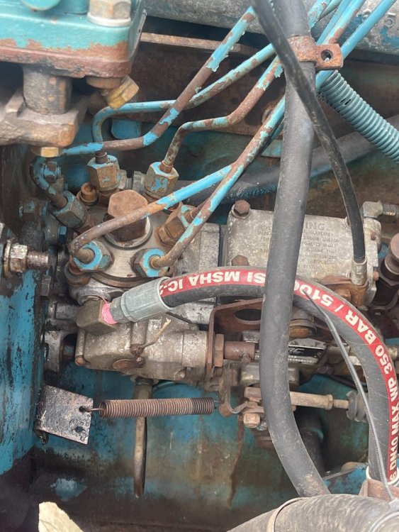

MarekK2491 Posted September 20, 2021 Author Share Posted September 20, 2021 I’ll send pic today. The inline pump started the next year model I believe Quote Link to comment Share on other sites More sharing options...
MarekK2491 Posted September 20, 2021 Author Share Posted September 20, 2021 This is what’s on the truck now. Need to see about what screws to adjust under the plate. Quote Link to comment Share on other sites More sharing options...

MinnesotaFarmall Posted September 22, 2021 Share Posted September 22, 2021 It has an Android valve on it, so I don't exactly know how that whole system works under the rectangular cover. Quote Link to comment Share on other sites More sharing options...
Injpumped Posted September 22, 2021 Share Posted September 22, 2021 everything is still the same as a tractor fuel stop, except there is a second sliding piston that moves the main one back and forth. So the aneroid pushes the whole thing to a normal position once it gets about 10 psi of boost. If it doesn't get boost to it or has a blown diaphragm it will be in the "no boost" fuel condition and be a big dog! Turn it up same as a tractor. The aneroid no air will change with it to some extent, but the rate is not adjustable. Confused yet? Quote Link to comment Share on other sites More sharing options...
MarekK2491 Posted September 22, 2021 Author Share Posted September 22, 2021 Is oem hose regular heater hose? how do we turn up the pump I really have no idea what I’m looking at and have searched for a picture or diagram Quote Link to comment Share on other sites More sharing options...
MarekK2491 Posted September 22, 2021 Author Share Posted September 22, 2021 Do you think hydraulic hose will cause loss in power? Quote Link to comment Share on other sites More sharing options...
striker782 Posted September 22, 2021 Share Posted September 22, 2021 Yes the hydraulic hose will cause horsepower loss. I had a customer’s 986 that I dynoed with a hydraulic hose then put on the OEM hose. It gained 15 horsepower just changing to the correct hose. Do not use heater hose. Just put on the correct one. Quote Link to comment Share on other sites More sharing options...
