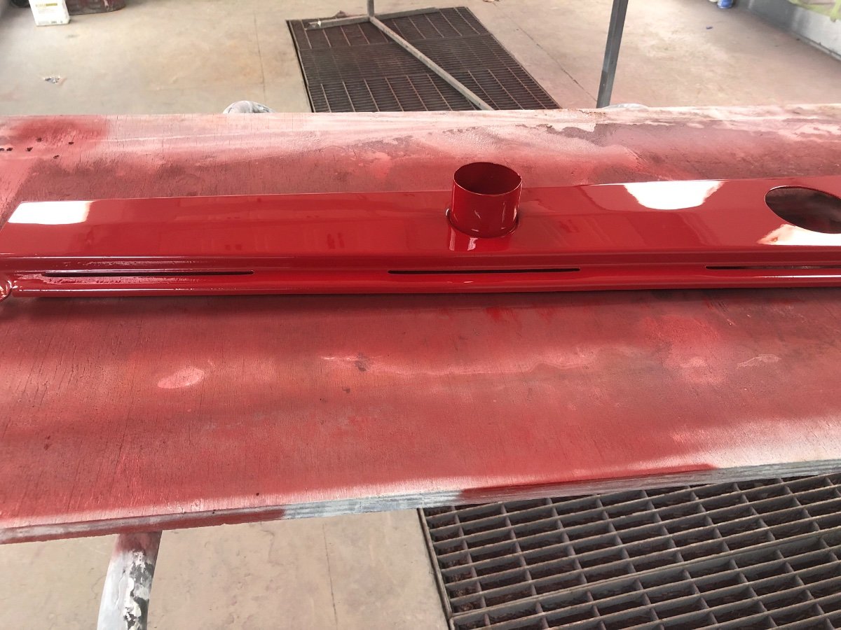

EHauck 122 Posted November 3, 2021 Author Share Posted November 3, 2021 Half of the white sprayed today and hopefully the rest tomorrow. 5 Quote Link to comment Share on other sites More sharing options...
EHauck 122 Posted November 5, 2021 Author Share Posted November 5, 2021 Just the side panels left to do and I’ll be done with white. 6 Quote Link to comment Share on other sites More sharing options...

ArkLa 1086 Posted November 30, 2021 Share Posted November 30, 2021 On 9/25/2021 at 6:11 PM, EHauck 122 said: Ppg delfleet essentials. This stuff is amazing and super tough! $800+ for 2 gallons of it but it was definitely worth it I don’t think I’ll ever go back to anything else at least for an in-depth restoration like this. Is paint all that you used? What kind of primer? Quote Link to comment Share on other sites More sharing options...
EHauck 122 Posted November 30, 2021 Author Share Posted November 30, 2021 17 hours ago, ArkLa 1086 said: Is paint all that you used? What kind of primer? Yeah I used a few primers. The frame and superstructure got a Cumberland epoxy primer. It was relatively inexpensive so hopefully I won’t regret that. Then on the hoods I used shopline by PPG, epoxy and surfacer. 1 Quote Link to comment Share on other sites More sharing options...
