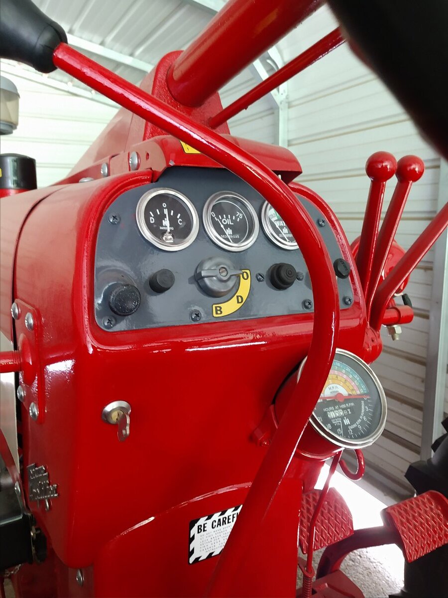

EHauck 122 Posted June 24, 2021 Author Share Posted June 24, 2021 I have a question about the dash panel. I’ve seen the inside is painted gray and I’ve also seen it black. Does anybody know the correct color? 1 Quote Link to comment Share on other sites More sharing options...
Nebraska1206 Posted June 24, 2021 Share Posted June 24, 2021 I believe there was a color difference, depending on the model year? I'm not 100% sure on that. 1 Quote Link to comment Share on other sites More sharing options...
rustred Posted June 24, 2021 Share Posted June 24, 2021 i have never saw a black dash. been around these tractors for over 50 years and only saw gray ones. plus all mine are grey too. i have heard of emntion of black but never saw one. its the grey like a fordson tractor. 1 Quote Link to comment Share on other sites More sharing options...
lorenzo Posted June 24, 2021 Share Posted June 24, 2021 Early 560’s were gray I think the change to black was 1961. It’s not a myth , the later ones are black no question about it. If yours is a 59 as previously stated then it should be grey. 1 Quote Link to comment Share on other sites More sharing options...
lorenzo Posted June 24, 2021 Share Posted June 24, 2021 1 hour ago, rustred said: i have never saw a black dash. been around these tractors for over 50 years and only saw gray ones. plus all mine are grey too. i have heard of emntion of black but never saw one. its the grey like a fordson tractor. If you would like to see some black ones there’s a junk yard with at least 30 560’s and almost as many 460’s with black painted dash’s in the line up . I can take some pictures for you .??? Quote Link to comment Share on other sites More sharing options...
nepoweshiekfarmalls Posted June 24, 2021 Share Posted June 24, 2021 My 61 460 is grey and my 63 560 diesel is black. 1 1 Quote Link to comment Share on other sites More sharing options...
EHauck 122 Posted June 24, 2021 Author Share Posted June 24, 2021 2 hours ago, lorenzo said: Early 560’s were gray I think the change to black was 1961. It’s not a myth , the later ones are black no question about it. If yours is a 59 as previously stated then it should be grey. So would anyone know an exact color. Or something close? 1 Quote Link to comment Share on other sites More sharing options...

Nebraska1206 Posted June 24, 2021 Share Posted June 24, 2021 1 hour ago, EHauck 122 said: So would anyone know an exact color. Or something close? There's a current New Holland gray that is very close, or at least that is the case for the dash on my Dad's 450. I would assume that's the same gray? If so, I think the spray can is still at the farm, let me see if I can find it & get a part number. 1 Quote Link to comment Share on other sites More sharing options...
nepoweshiekfarmalls Posted June 25, 2021 Share Posted June 25, 2021 3 hours ago, EHauck 122 said: So would anyone know an exact color. Or something close? I used dove gray on my 460. The flat black from CIH looks good on the later ones. 2 Quote Link to comment Share on other sites More sharing options...
lorenzo Posted June 25, 2021 Share Posted June 25, 2021 17 hours ago, nepoweshiekfarmalls said: I used dove gray on my 460. The flat black from CIH looks good on the later ones. I choose gloss black . 9 Quote Link to comment Share on other sites More sharing options...
Nebraska1206 Posted June 26, 2021 Share Posted June 26, 2021 This is the can of New Holland gray that was used on the dash panel of my Dad's Farmall 450 when he had it repainted. Ken Wood from Canada (rest in peace, buddy!!) gave me the part number for this many years ago, and I happened to obtain a can for my Dad. Part number 86109004DS. 6 1 Quote Link to comment Share on other sites More sharing options...
lorenzo Posted June 26, 2021 Share Posted June 26, 2021 1 hour ago, Nebraska1206 said: This is the can of New Holland gray that was used on the dash panel of my Dad's Farmall 450 when he had it repainted. Ken Wood from Canada (rest in peace, buddy!!) gave me the part number for this many years ago, and I happened to obtain a van for my Dad. Part number 86109004DS. Nice finish, It’s all in the details . 1 Quote Link to comment Share on other sites More sharing options...
EHauck 122 Posted June 30, 2021 Author Share Posted June 30, 2021 I got ahold of some of that paint. I think it is looking pretty good. I got some other small things done too. This recent heat wave is having me praying for a nice air conditioned shop. 6 Quote Link to comment Share on other sites More sharing options...
lorenzo Posted June 30, 2021 Share Posted June 30, 2021 10 hours ago, EHauck 122 said: I got ahold of some of that paint. I think it is looking pretty good. I got some other small things done too. This recent heat wave is having me praying for a nice air conditioned shop. When that’s all finished with the instruments in place and under that black steering wheel she’s going to look sharp . ?? 1 Quote Link to comment Share on other sites More sharing options...
rustred Posted June 30, 2021 Share Posted June 30, 2021 13 hours ago, EHauck 122 said: I got ahold of some of that paint. I think it is looking pretty good. I got some other small things done too. This recent heat wave is having me praying for a nice air conditioned shop. ya looks good. i see u did the whole panel. plus the steering wheel looks like the 560 wheel. far as i know 660 wheel not available. its a bigger wheel. 3 Quote Link to comment Share on other sites More sharing options...
EHauck 122 Posted June 30, 2021 Author Share Posted June 30, 2021 3 hours ago, rustred said: ya looks good. i see u did the whole panel. plus the steering wheel looks like the 560 wheel. far as i know 660 wheel not available. its a bigger wheel. My plan is to paint the gray on first and then tape it off and spray red. I tried hunting and hunting for an original 660 wheel but I couldn’t find anything. But I am keeping my old one in case I would ever get a chance to restore it. 4 Quote Link to comment Share on other sites More sharing options...

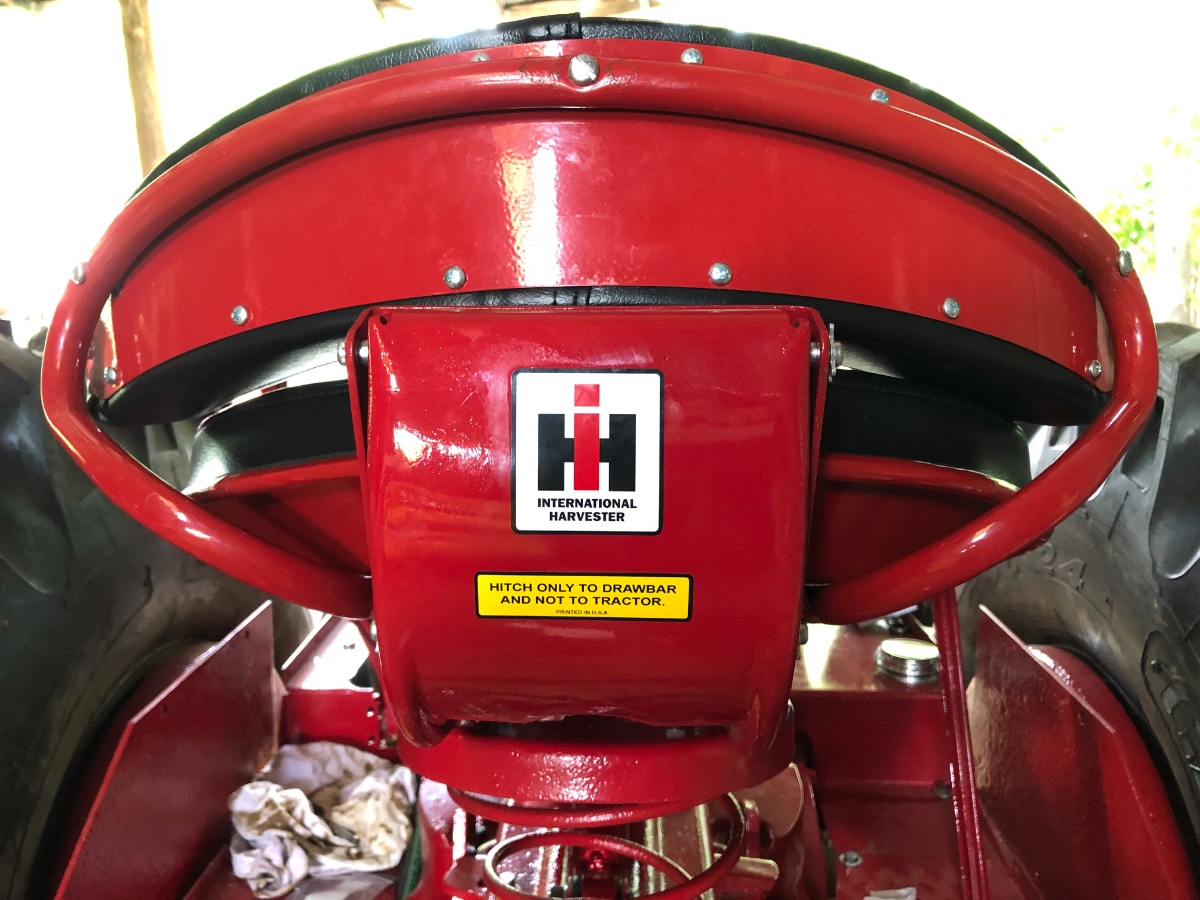

EHauck 122 Posted June 30, 2021 Author Share Posted June 30, 2021 I have my seat completely assembled now. This is the first time I’ve ever gotten to sit in a “Brand new“ Farmall/international seat. 5 Quote Link to comment Share on other sites More sharing options...

EHauck 122 Posted August 21, 2021 Author Share Posted August 21, 2021 Long time no update. My entire summer has pretty much been booked mainly because of being my dad’s head hay Tedder, Raker, and wagon puller. And also the head mechanic I got busy with redoing the AC in our 7740 and rebuilding our 1466 motor. But this weekend I finally was able to get some good work done. I finished up painting the dash and got some of the gauges in. The rest of the stuff I am waiting for yet. Also today marks three weeks that Jeff has had my emblems so hopefully in a week or so I will get them back also 8 Quote Link to comment Share on other sites More sharing options...
