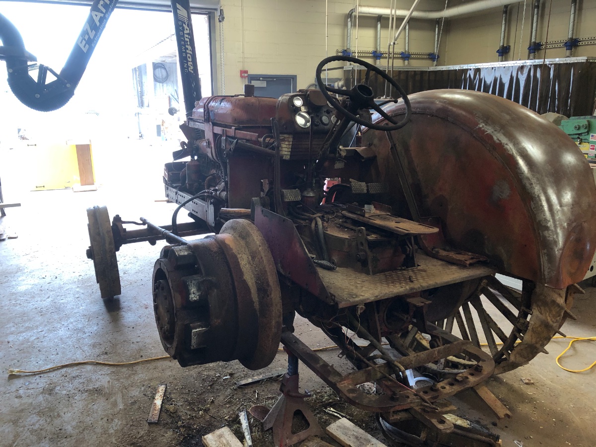

EHauck 122 Posted April 17, 2021 Share Posted April 17, 2021 So far this project is about a year in. This is our progress as of now 13 Quote Link to comment Share on other sites More sharing options...
DT Fan Posted April 17, 2021 Share Posted April 17, 2021 That is respectable progress! Not the easiest restoration ever undertaken. 2 Quote Link to comment Share on other sites More sharing options...
rustred Posted April 17, 2021 Share Posted April 17, 2021 your hard at it. i was just wondering if you drained the trans, and diff oil. , as it might have a lot of water. plus the shifting rails could be rusted up. i imagine it will get rubber tires now. 1 Quote Link to comment Share on other sites More sharing options...
EHauck 122 Posted April 17, 2021 Author Share Posted April 17, 2021 5 hours ago, rustred said: your hard at it. i was just wondering if you drained the trans, and diff oil. , as it might have a lot of water. plus the shifting rails could be rusted up. i imagine it will get rubber tires now. Yes I did. About 50% water ? 1 Quote Link to comment Share on other sites More sharing options...
nepoweshiekfarmalls Posted April 18, 2021 Share Posted April 18, 2021 Wow! A neat project. Looks cool on steel wheels. Not as many gas 660 around. Congratulations. 1 Quote Link to comment Share on other sites More sharing options...
rustred Posted April 18, 2021 Share Posted April 18, 2021 23 hours ago, EHauck 122 said: Yes I did. About 50% water ? did you have a look in there? can you shift the gears? 1 Quote Link to comment Share on other sites More sharing options...
EHauck 122 Posted April 18, 2021 Author Share Posted April 18, 2021 2 hours ago, rustred said: did you have a look in there? can you shift the gears? Yes I did. Everything seemed fine I had the transmission cover off and I had the PTO out shifting seems pretty nice but I did find these in the rear end from the differential. 1 Quote Link to comment Share on other sites More sharing options...

rustred Posted April 20, 2021 Share Posted April 20, 2021 On 4/18/2021 at 4:32 PM, EHauck 122 said: Yes I did. Everything seemed fine I had the transmission cover off and I had the PTO out shifting seems pretty nice but I did find these in the rear end from the differential. well i hope all the bolts are in the diff now. dont know why someone would leave those bolts in there. what year is that unit? what all have you done to the engine. 660 gas not common. 1 Quote Link to comment Share on other sites More sharing options...
nomorejohndeere Posted April 20, 2021 Share Posted April 20, 2021 I wish they had that opportunity where I went to school 2 Quote Link to comment Share on other sites More sharing options...
EHauck 122 Posted April 21, 2021 Author Share Posted April 21, 2021 23 hours ago, rustred said: well i hope all the bolts are in the diff now. dont know why someone would leave those bolts in there. what year is that unit? what all have you done to the engine. 660 gas not common. It’s a 59 serial #3066 I got the head completely gone over but the bottom end was in good shape so I didn’t do anything to it. I replaced both of the bolts, they weren’t left there, those crazy mennonites were so rough on it that somehow they snapped. They hold the differential case together 2 Quote Link to comment Share on other sites More sharing options...
