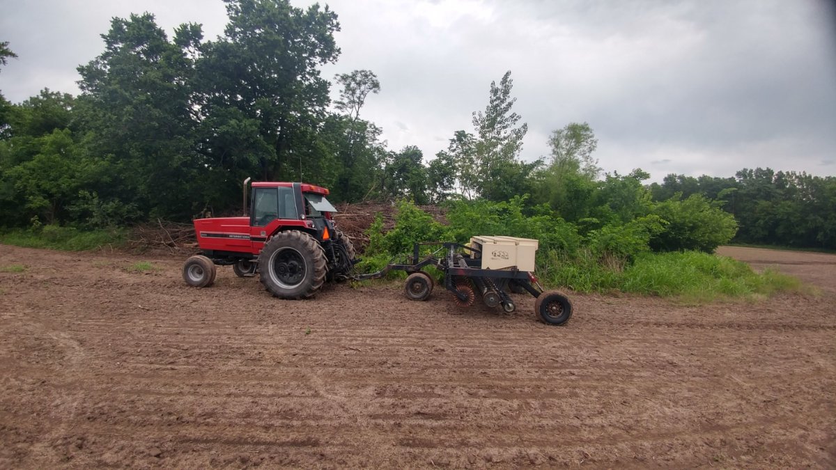

searcyfarms Posted April 15, 2021 Share Posted April 15, 2021 @1586 Jeffbest pix I could find of the truax i rented from the FSA/NRCS office Link to comment Share on other sites More sharing options...

1586 Jeff Posted April 15, 2021 Author Share Posted April 15, 2021 2 hours ago, searcyfarms said: @1586 Jeffbest pix I could find of the truax i rented from the FSA/NRCS office I cannot tell from the pictures, can that drill be pulled endwise? Link to comment Share on other sites More sharing options...
