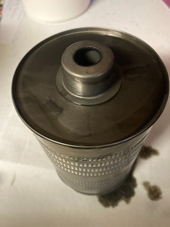

Josh123 Posted March 17, 2021 Share Posted March 17, 2021 Hi, I just got finished overhauling a 54 super wd9 and I'm having trouble finding an oil filter for it, the number on the old one is worn off. I took the old one to my local case dealer and they couldn't find a part number for it. do any of you know the part number and where I could find a filter. The pictures are of the filter that was in it. Thanks Quote Link to comment Share on other sites More sharing options...

Rainman Posted March 17, 2021 Share Posted March 17, 2021 Crossed to WIX 51155 Quote Link to comment Share on other sites More sharing options...
Josh123 Posted March 21, 2021 Author Share Posted March 21, 2021 Thank you J-Mech and Rainman the dimensions are right, I don't know how the guys at case couldn't find it Quote Link to comment Share on other sites More sharing options...

FarmallFan Posted October 21, 2021 Share Posted October 21, 2021 On 10/19/2021 at 8:32 PM, Josh123 said: Rustred if you could post the case ih part number that would be great. I think the part number should be 376376R91. Quote Link to comment Share on other sites More sharing options...
rustred Posted October 21, 2021 Share Posted October 21, 2021 43 minutes ago, FarmallFan said: I think the part number should be 376376R91. i would have to look on my bill. why not just ph and ask someone with knowledge, its the parts man's job. try to remember tonight. there is nothing hard to get those filters. Quote Link to comment Share on other sites More sharing options...
rustred Posted October 21, 2021 Share Posted October 21, 2021 Just now, rustred said: i would have to look on my bill. why not just ph and ask someone with knowledge, its the parts man's job. try to remember tonight. there is nothing hard to get those filters. also NAPA can get them . i have bought at both places. Quote Link to comment Share on other sites More sharing options...
rustred Posted October 23, 2021 Share Posted October 23, 2021 raining now ,and dug out a bill and its 376374R 91 Quote Link to comment Share on other sites More sharing options...
R190 Posted November 1, 2021 Share Posted November 1, 2021 376374r91 is the short smaller diameter filter used on a farmall A through504 and H through 350 , The correct filter is 375376r91 it fits the MD through 650 diesel some early Ms and the gas w9 through 650 the 376375R91 fits just about any thing not mentioned in letter series plus a few early As , B s, and Hs Quote Link to comment Share on other sites More sharing options...
Dell Posted July 18 Share Posted July 18 i have a early m and it takes a Napa 1155, and it needed a gasket/ seal napa fil 5074. the same filter in hasting is a lf485. If rainman is correct wix makes napa filters. and that 1155 should work. i would check your s/n and and look it up. Quote Link to comment Share on other sites More sharing options...
R190 Posted July 18 Share Posted July 18 376376r91 has now been superseded to a new number 3062832r91 and is available from caseih. Quote Link to comment Share on other sites More sharing options...
