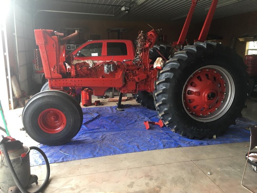

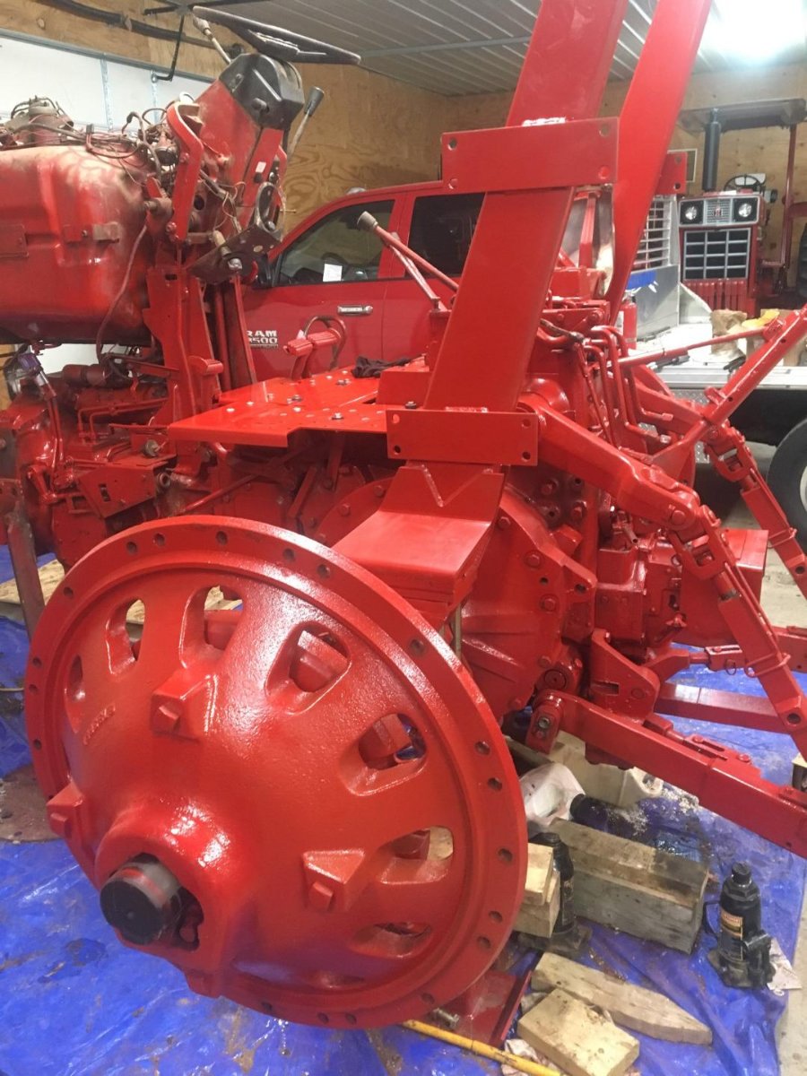

Vanstractors 154 Posted February 18 Share Posted February 18 Torsion Bushings done,Lift Arms Extend now ,Roll Bar,Motor Done Waiting on Head . 12 Quote Link to post Share on other sites
B.B. 690 Posted February 22 Share Posted February 22 You can come do the bushings on my 1586 now that you have practiced! Looking good! 1 Quote Link to post Share on other sites
Vanstractors 154 Posted February 23 Author Share Posted February 23 First 15 was a little tough shafts come out opposite sides each other .I tacked a couple of nuts in the old bushings to drive them out .Then used retaining gland and old steel bushing with four guides to pull in the new composite ones .If the right wheel is in tight going to be tough .Like always i got a lot of help from this forum ! And Thank You ! 5 Quote Link to post Share on other sites
Vanstractors 154 Posted March 22 Author Share Posted March 22 New Sneakers ! A couple sets weights inside .Still waiting on Head and looking for Fenders . 9 Quote Link to post Share on other sites
lorenzo 15,203 Posted March 31 Share Posted March 31 On 3/22/2021 at 6:02 PM, Vanstractors said: New Sneakers ! A couple sets weights inside .Still waiting on Head and looking for Fenders . These are in Omaha on Craigs list . 1 Quote Link to post Share on other sites
