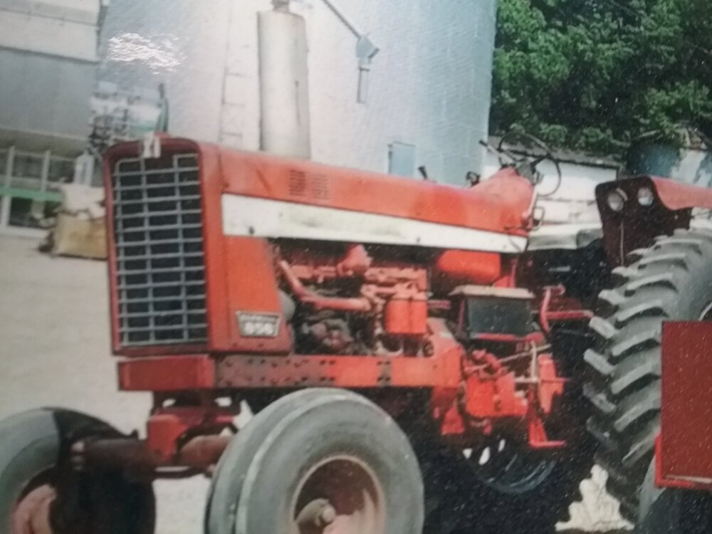

IH FARMS Posted December 29, 2020 Author Share Posted December 29, 2020 Found a picture before I started this project ,not very clear. And a few new ones. Got it pushed back together today. 9 Quote Link to comment Share on other sites More sharing options...

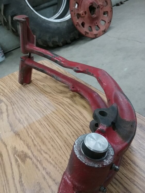

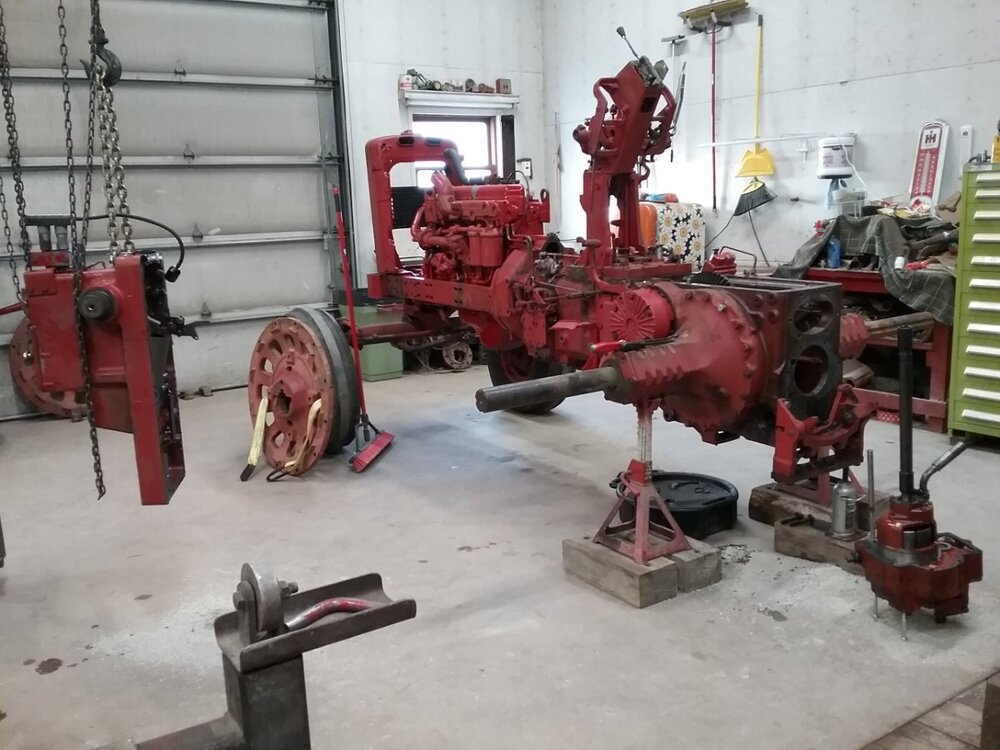

IH FARMS Posted January 5, 2021 Author Share Posted January 5, 2021 Did a little more disassembling on the 856. Disassembled the diesel pump drive and installed new seals and gaskets. The diesel pump was completely disassembled at professional diesel shop and completely gone through. Installed new seal kit in steering hand pump. Removed all wiring and decided to go with all new harnesses. Disassembled rear wheels and going to sandblast castings prime and paint them. Got the clutch and brake pedals bored and new bushings installed and new shafts made that they pivot on. Replaced suction seal in hydraulic filter housing that leads to new hydraulic pump and new oring on main suction tube. Removed rear end top cover and found eccentric part#382828R91 worn out and slipping past the pin it rides on. Found a good one so that problem is solved. Installing new seals on top rockshaft and new orings on lower shaft. Disassembled lift cylinder and installed new seal kit. New axle seals and orings. Disassembled and rebuilt the PTO. My daughter has an AG class for school so she got a hands on project. She helped with the clutch job. She disassembled the remote control valves and installed new actuators and orings and reassembled. She also helped install the new hydraulic pump. 14 Quote Link to comment Share on other sites More sharing options...
IH FARMS Posted January 5, 2021 Author Share Posted January 5, 2021 On 1/4/2021 at 8:17 AM, J-Mech said: This looks more like a repaint than a restoration. Restorations have a lot more disassembly and rebuilding. What are you using to prep the metal? Wire wheel? Primer, if so what? Did you just sand the hoods and paint them? I don't see any primer over-spray on the frame rails. Red oxide primer over spray. Sheet metal was straightened and sanded to bare metal primed then painted. I never use a wire wheel. I put over 100 hours on this tractor doing various farm work. The engine runs very good. The TA works great with good pressures. The rear end is also in great shape,,no iron in hydraulic filter or visible damage anywhere. No reason to disassemble something that isn't broken. This tractor just leaked everywhere and three point hitch didn't work and had a weak rear pump. 7 1 Quote Link to comment Share on other sites More sharing options...
nepoweshiekfarmalls Posted January 5, 2021 Share Posted January 5, 2021 Sounds like you are giving it attention in the areas that need it. Cleaning and painting behind close areas as you go makes sense. Eliminate paint shadows that way. 3 1 Quote Link to comment Share on other sites More sharing options...
IH FARMS Posted January 5, 2021 Author Share Posted January 5, 2021 53 minutes ago, nepoweshiekfarmalls said: Sounds like you are giving it attention in the areas that need it. Cleaning and painting behind close areas as you go makes sense. Eliminate paint shadows that way. Thanks,,,,your 100% on...forgot to mention that I disassembled the tilt wheel and put in a new bushing. 2 Quote Link to comment Share on other sites More sharing options...
