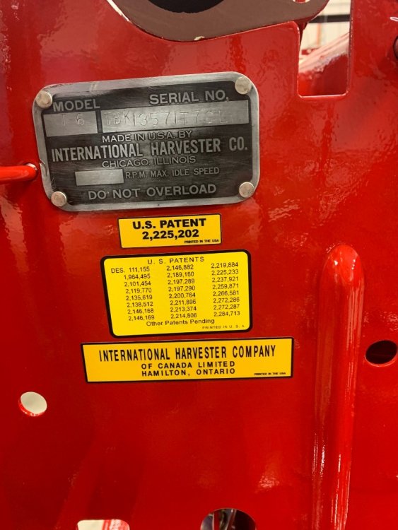

Mogulman Posted November 24, 2022 Author Share Posted November 24, 2022 Old and new. Thanks to TD-18 for the patent numbers decal (center decal). × 1 Quote Link to comment Share on other sites More sharing options...

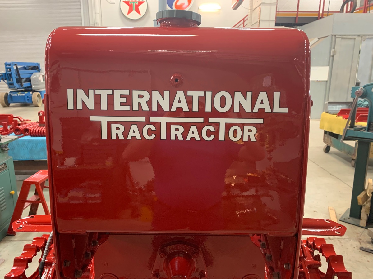

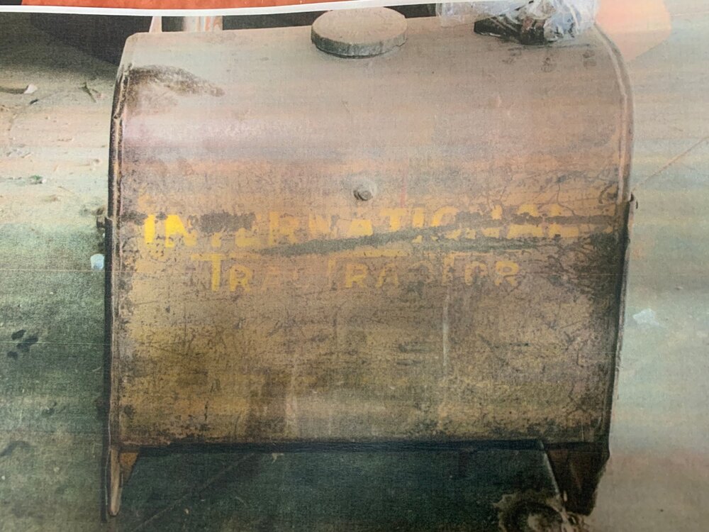

Mogulman Posted December 9, 2022 Author Share Posted December 9, 2022 This the vision that remained of the original decals on the back of the tank and then the new decals in place. We had all the decals made for this and the sides since the original font was different than what was in the decal kit we bought. 4 Quote Link to comment Share on other sites More sharing options...
hardtail Posted December 9, 2022 Share Posted December 9, 2022 What year was it, cool on remaking the decals, that must be an early one for those style? Quote Link to comment Share on other sites More sharing options...
Mogulman Posted December 9, 2022 Author Share Posted December 9, 2022 4 hours ago, hardtail said: What year was it, cool on remaking the decals, that must be an early one for those style? 1946…so prior to the IH logo being adopted. That was 1948. Quote Link to comment Share on other sites More sharing options...
