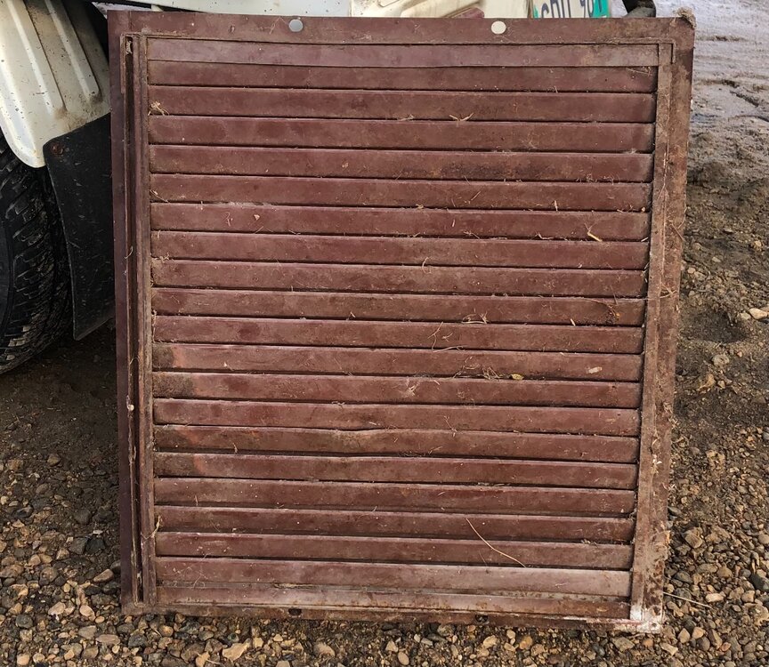

Mogulman Posted March 7, 2021 Author Share Posted March 7, 2021 As we learn, we discovered that this T-6 had shutters. A few inquiries and we have found what we need. Quote Link to comment Share on other sites More sharing options...

Mogulman Posted March 10, 2021 Author Share Posted March 10, 2021 One item we discovered was missing was the radiator shutters. There are some good people in this hobby. In less than a day after I put out the word, a set of shutters was found and on its way. Complete with all the control rods and even a second set of control rods to ensure we had the best set possible. 2 Quote Link to comment Share on other sites More sharing options...
