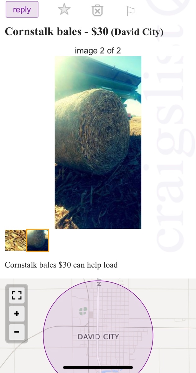

lorenzo Posted November 9, 2020 Share Posted November 9, 2020 Here’s what there worth around here. we don’t like to remove all that organic matter from the field but a few people are doing it I guess. Link to comment Share on other sites More sharing options...
