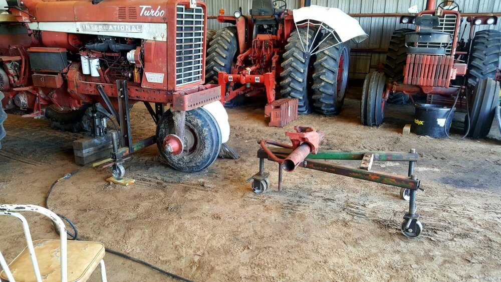

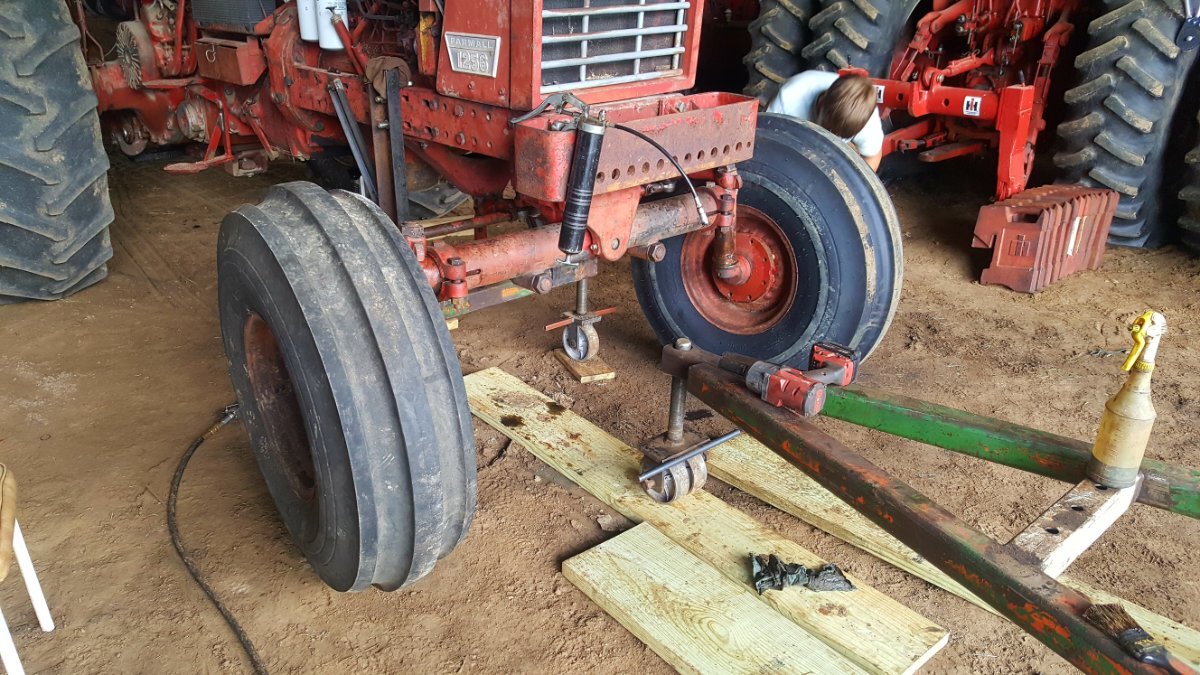

Jeff-C-IL Posted July 8, 2021 Share Posted July 8, 2021 Did I miss something.....all that work to free up the wide front and then....all the sudden a narrow? BTW, I made a "wrench" out of 1" plate with heavy tabs to fit around the outer axle and drop a pin thru the holes. Smacking the end on this wrench with a maul was the only was I got my 666 tube to finally start moving. Even then it took a 20 ton jack and hitting it to rotate 1/4" one way, then 1/4" the other ALL THE WAY OUT...... And end the end the wrench broke. Link to comment Share on other sites More sharing options...
TP from Central PA Posted July 8, 2021 Share Posted July 8, 2021 30 minutes ago, Jeff-C-IL said: Did I miss something.....all that work to free up the wide front and then....all the sudden a narrow? Thumbs up on both hands from me! Link to comment Share on other sites More sharing options...

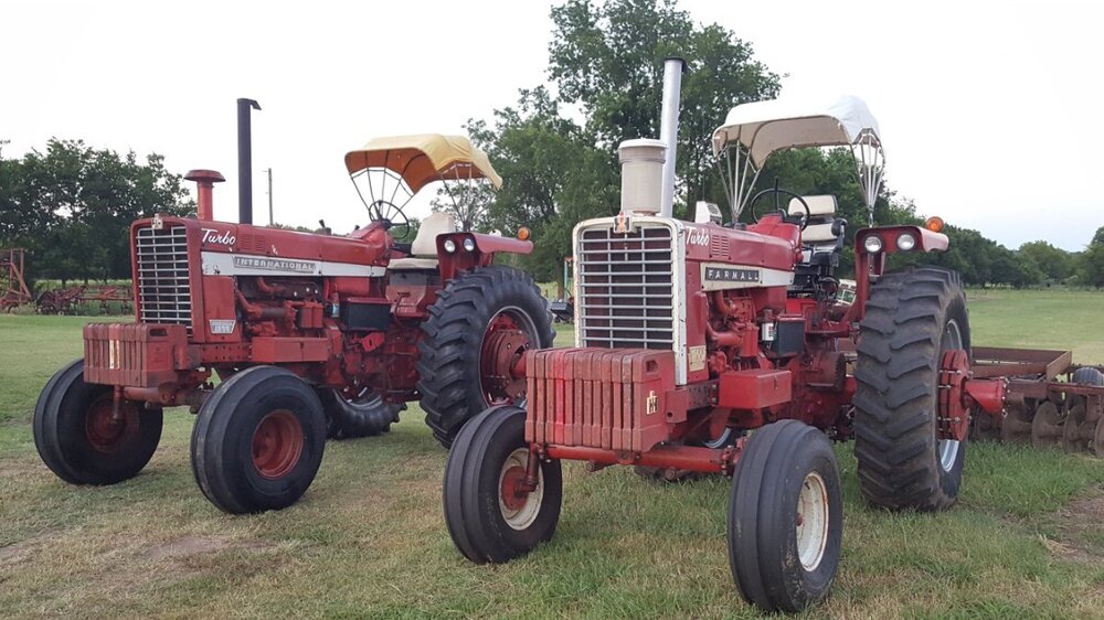

Long Farms Posted July 8, 2021 Author Share Posted July 8, 2021 I didn't beat those knees. This front axle came all apart in just min. Someone before me got nasty with it. Center pivot pin hole was too worn for new bushings. Had it machined and its sitting off to side for reassemble. Wanted NF 1256 pics too before i put WF back on. Link to comment Share on other sites More sharing options...

nepoweshiekfarmalls Posted July 10, 2021 Share Posted July 10, 2021 What am I seeing just beyond the front of the 1256, under the white buggy top? Are those cast center duals? Link to comment Share on other sites More sharing options...
Long Farms Posted July 10, 2021 Author Share Posted July 10, 2021 Yes and no. Had a set of 38x14 rims powder coated and 15.5x38 tires mounted. It's easier if they are fixed to tractor to mount so i anchored them to a long axle tractor and havent had time or need to pull them off. Link to comment Share on other sites More sharing options...
nepoweshiekfarmalls Posted July 12, 2021 Share Posted July 12, 2021 On 7/10/2021 at 1:56 PM, Long Farms said: Yes and no. Had a set of 38x14 rims powder coated and 15.5x38 tires mounted. It's easier if they are fixed to tractor to mount so i anchored them to a long axle tractor and havent had time or need to pull them off. Thanks! That entire situation did not look normal to me. Link to comment Share on other sites More sharing options...
