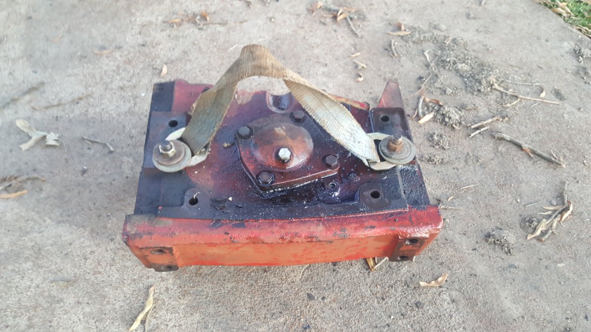

Long Farms Posted December 5, 2020 Author Share Posted December 5, 2020 Rebuilt shifter high/low/rev top plate, shift levers, added a used hycap trans brake rod, pulled radiator and had it checked and cleaned at shop, power washed radiator support, pulled frame rail to replaced brazed steering line and replace leaking oring on wet bolster.  1 Quote Link to comment Share on other sites More sharing options...

Long Farms Posted December 9, 2020 Author Share Posted December 9, 2020 Yeah buddy, turns out end cap o ring wasnt the one leaking. Total rebuild/reseal now. Atleast i can power wash underneath bolster.  3 Quote Link to comment Share on other sites More sharing options...
Farmall1066 Posted December 10, 2020 Share Posted December 10, 2020 Well now you know it won’t leak there again! Looks good Brian! Quote Link to comment Share on other sites More sharing options...
cwinn Posted December 10, 2020 Share Posted December 10, 2020 Â Are those bolsters a bear to rebuild or fussy? Â Never been that deep. Quote Link to comment Share on other sites More sharing options...
Long Farms Posted December 12, 2020 Author Share Posted December 12, 2020 Not that bad but pricey. New bottom bearing and race is pain to remove. Have to be carefull with teflon seals and compressing them to fit back and and get one past the center opening. Lots of crap and gunk builds up in there. Suprised how nasty it was but since used motor was main source of hyd oil for no telling how long, it shouldnt have suprised me. 2 Quote Link to comment Share on other sites More sharing options...
