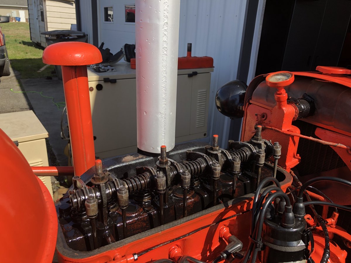

Tj01 Posted February 17, 2020 Author Share Posted February 17, 2020 Today it hit the mid 60’s around here so why not just spend the day working on the tractor! So I took the valve cover off and check valve adjustment. Only one valve was out of adjustment so readjusted it and now she runs smoother than ever. Now it’s time to wash and wax this girl for a tractor show coming up Feb 29. Rumor has it I might get to plow with this girl with my one bottom plow lol 2 Quote Link to comment Share on other sites More sharing options...

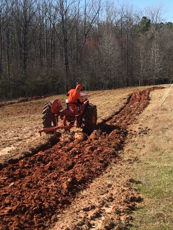

Tj01 Posted March 2, 2020 Author Share Posted March 2, 2020 I figured y’all already saw in the coffee shop but figured would do a post on here. Well went to the tractor show and saw some very pretty tractors while I was there. Everyone who came through got a token and got to vote on which tractor was the best. I can’t believe with all the good looking tractors there that I won! After the show me, Brody, and Brody’s dad went down to our schools FFA barn and plowed for mine and Brodys first time. What a great experience! 1 Quote Link to comment Share on other sites More sharing options...

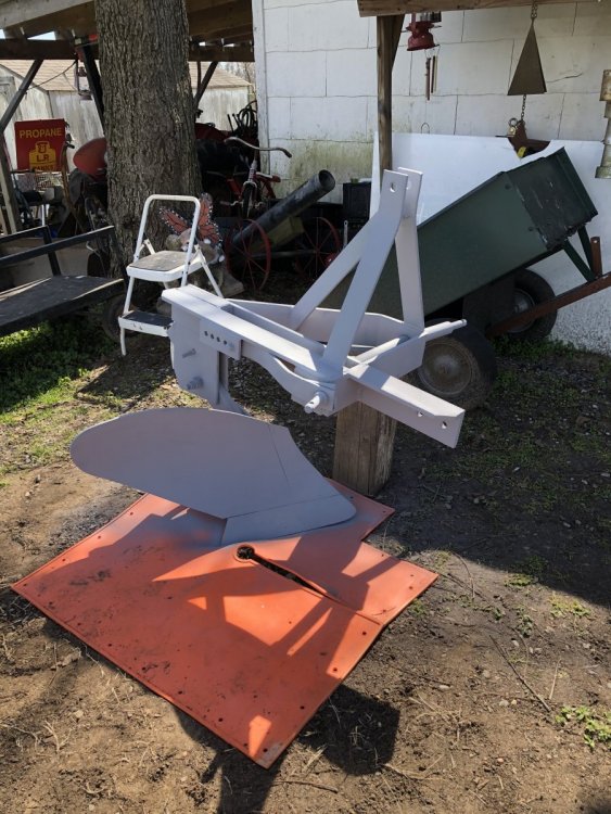

Tj01 Posted March 12, 2020 Author Share Posted March 12, 2020 After the tractor show l started cleaning the rust off the one bottom plow for paint. Put one coat of primer on it and then sprayed the frame with orange and the moldboard with black. Now I’m in the process of buying a another Allis. A Allis Chalmers WD. 3 Quote Link to comment Share on other sites More sharing options...
