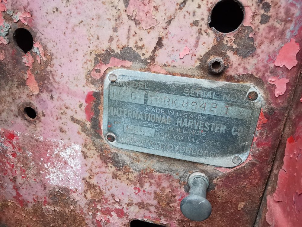

Ds Devine Posted October 7, 2019 Share Posted October 7, 2019 I bought this TD6 at an auction on Sat along with what I presume is a replacement engine as the one in it has a con rod out through the side. Anyone know what age it roughly is has and American Bosch pump! But the front track wheel is really odd!! So I don't if bought a gather up of bits or what it is!! Quote Link to comment Share on other sites More sharing options...

north of 60 Posted October 15, 2019 Share Posted October 15, 2019 By serial number on the tag I think it is a 1942 model .. Quote Link to comment Share on other sites More sharing options...

Red-to-go Posted October 16, 2019 Share Posted October 16, 2019 Nice looking machine. Here’s the site you can get the year, no of 60 is right looks like a 1942 http://www.tractordata.com/farm-tractors/003/3/2/3326-international-harvester-td-6.html those front idlers look like they are adjust out as far as they will go! You might have to remove a shoe and link to shorten the track up. I don’t know if I would run it that close to the end of the rail. That idler adjuster is at the end of its thread. How are the bushings in the undercarriage? Quote Link to comment Share on other sites More sharing options...
