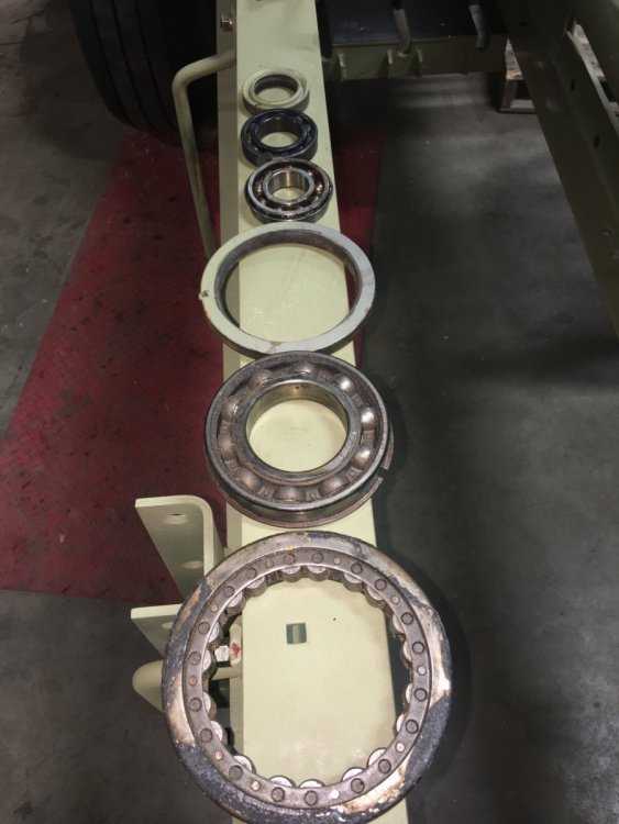

Tonyinca Posted January 30, 2020 Author Share Posted January 30, 2020 1/29/20 Still waiting on gear box , as the larger bearings with snap rings in center of carrier had to be ordered , they arrived yesterday ,now up to machine shop. Kaman bearing asked ,"what are these out of and what age " ? Said , "don't see these around much any more ". Two of them had snap ring on center of carrier and most had I.H. # with ST and three #'s only. John an I worked on knotter system, evaluated parts and condition and wear , on all three, to find the best to make one. Need to bush knotter clutch plate and have new clutch pad made. Lot of roll pins to remove , gears to free up , however , this particular knotter seems to have " In tolerance " wear on most parts. Springs were bad on trip dog and roller was stuck , as were all other rollers on this baler .lol The wire knives need polishing two we'll sharpen and should be like new third we need to replace with a better one from other. Few pics Tony BTW those bearing in pic are what I ordered , Your looking at 520.00 dollars there. OUCH 3 Quote Link to comment Share on other sites More sharing options...

Tonyinca Posted February 22, 2020 Author Share Posted February 22, 2020 Finally have gear box back all bearings seals replaced shafts polished , keyways squared. twister clutch was refaced , and rebushed, and new clutch pad made. I might say my pocket book got polished also with the machining and bearing costs . Lol lol. John and I have been so busy with Ag Expo and life that we have missed February. hope to hit it most of March while I prepare for Cafeshow lot of meetings coming up so time going to be scarce till Third weekend of April then getting everything back to normal after . meantime David the painter is starting on most of sheet metal . tony 6 Quote Link to comment Share on other sites More sharing options...
