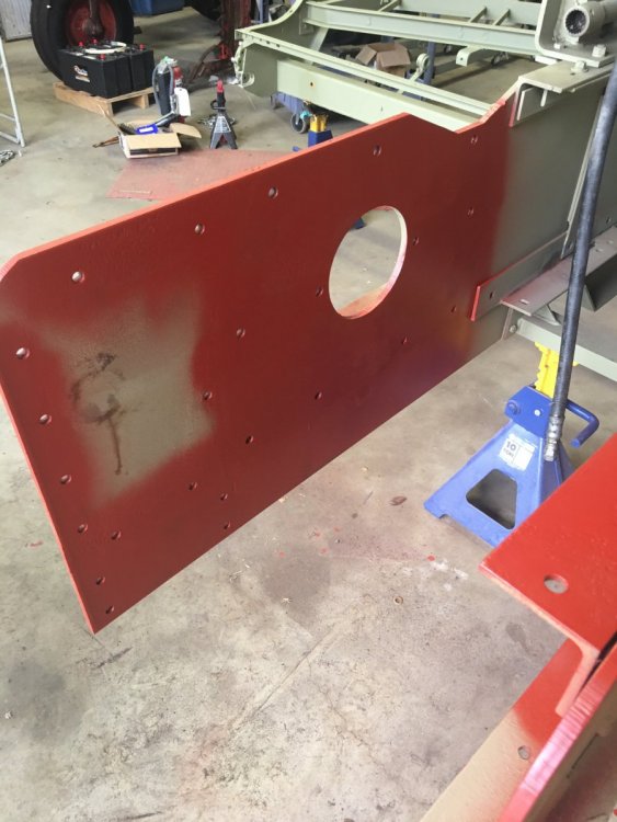

Tonyinca Posted December 14, 2019 Author Share Posted December 14, 2019 13 minutes ago, Farmall1066 said: Its not my baler, and I’m getting excited!!! You must be thrilled to see it coming back together!! Blaine It’s unbelievable to me that there is nothing left to take off ! parts are being repaired and now the fun begins , I hope ! two safety shields should be done by next week , then I can bring template machine home with new sheet metal so I can get it blasted and primed. Then all of sheet metal will be done . tony 2 Quote Link to comment Share on other sites More sharing options...

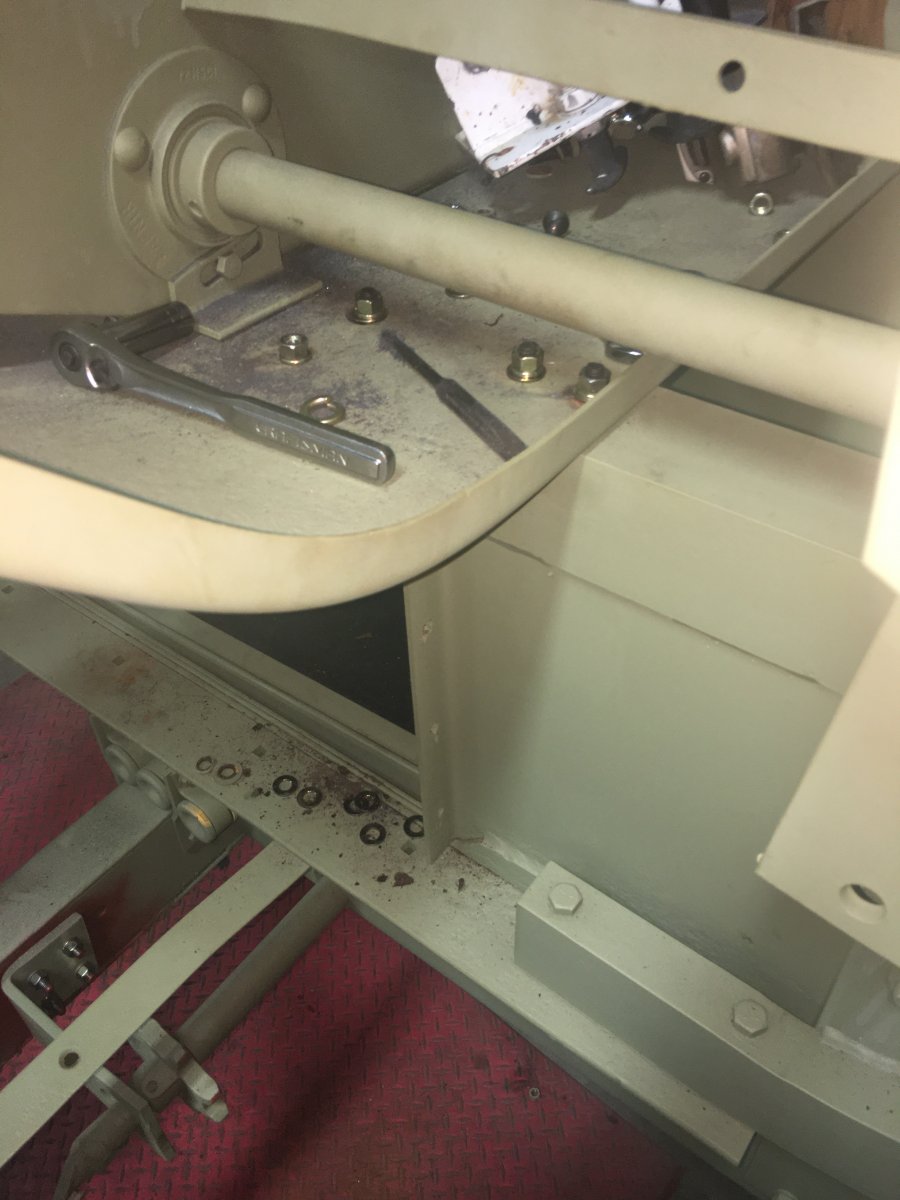

Tonyinca Posted January 17, 2020 Author Share Posted January 17, 2020 1/15/20 Good “Baler therapy “shop day ! we got chamber floor done and all cinched down . finished working on plunger ready to install . was working on heavy side axle found serious defect , pulled another from donor Will blast , change bearings . Need to get baler on wheels to roll out for position to install plunger. Gear box should be back from machine shop next week. Getting new sheet metal blasted and primed. once we get plunger in , we’ll move on to the knotters few pic’s tony 1 Quote Link to comment Share on other sites More sharing options...

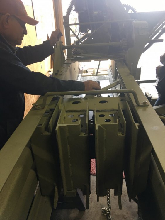

Tonyinca Posted January 25, 2020 Author Share Posted January 25, 2020 1/24/20 Great" Baler shop therapy" session , after a grueling week of appointments and meetings. We installed plunger back in . Unfortunately my Dear Nieghbor Eddie stopped by just as John and I were about to start installing , so being he was here and helped us remove it , I thought it only appropriate for him to help us install it as I took pics ! Lol lol. We think we have her ready for gear box and plunger crank , hopefully next week had to order few of the older style bearings . we put axles back on and new wheel bearings and set her back down on tires. i am working on getting all sheet metal prepped and will start sending parts to painter . few pics of today’s endeavor tony 4 Quote Link to comment Share on other sites More sharing options...
