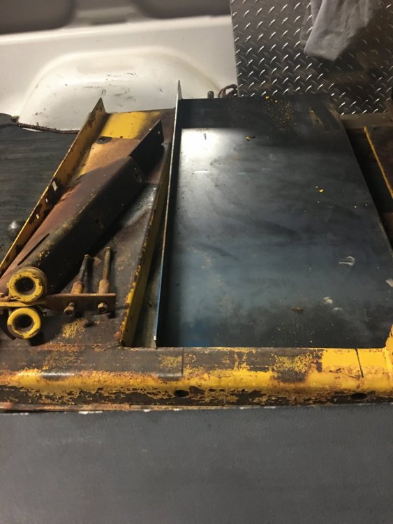

Tonyinca Posted December 6, 2019 Author Share Posted December 6, 2019 Today , Thursday 11/5/19 , checked with sheet metal man , the bale shoot is done , only thing left is the two side shields one over Auger belt on light side and other over the knotter chain on the heavy side. Earlier I had talked of making a inter small wheel jack so to lift to roll onto my gooseneck . spent morning measuring and roll play it and decided to abandon the idea . I saw it done on a 55W but it’s a much narrower machine and more room for the added items . To make this girl fit on my 102 “ trailer , I would need to remove axles both sides then it would be 97”. at my age I am not going to do that much work to haul it ,mostly I'll be taking it 60 miles to Tulare , I’ll either tow it or have it hauled by a professional trucker . My friend Mel has a low boy with expandable side on it . few pic ‘s 1st three is the donor gear box with good gears but in need of bearings , next is a crappy pic of the bale shoot with few parts on it headed for blast and primer and last pic , right plunger crank bracket headed for blast the pillar bearing in it was stiff like it never turned . Lol tony 2 Quote Link to comment Share on other sites More sharing options...
