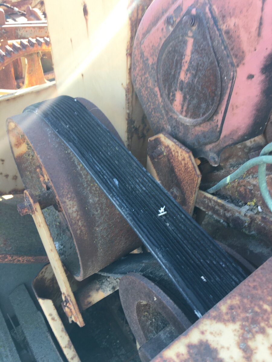

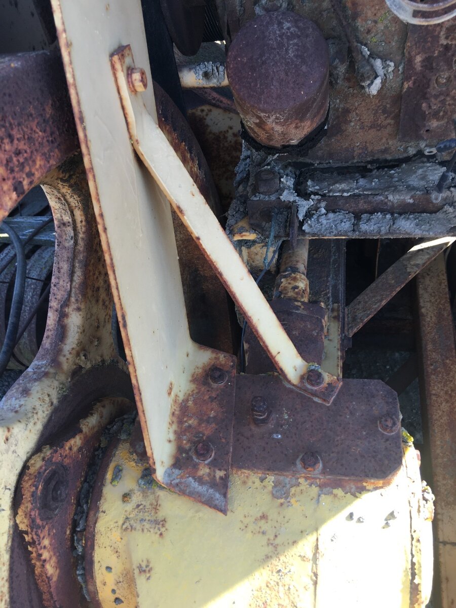

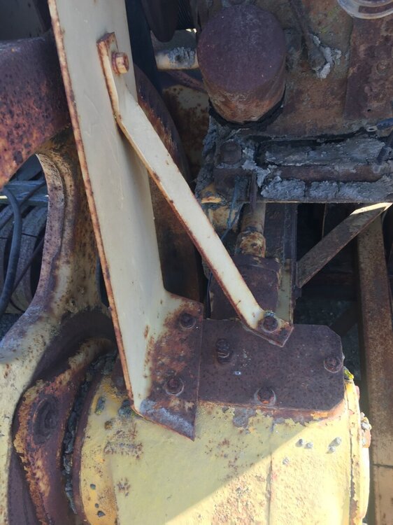

Tonyinca Posted December 1, 2020 Author Share Posted December 1, 2020 Interesting day ! a friend of mine notified me that he saw a #71 in a retired iron lot on a large ranch About 40 miles N/W of me . I had free time this Am and I found it . Met the foreman he said look at it all you want but it’s not fore sale i must of spent an hour looking at it and taking few pictures . like to share these with you was great to see one on a farm where it was used and saved . it’s amazing the deterioration on a central Ca machine , much worse then the three I had to work with but it was all there in tact . Being we are going back together on ours ,it was very helpful to study this machine and take these pic’s . Hope you enjoy tony 4 Quote Link to comment Share on other sites More sharing options...
