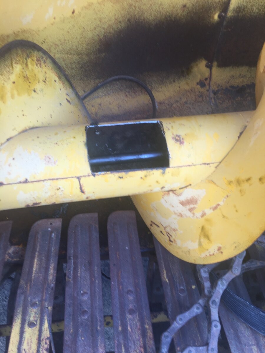

Tonyinca Posted October 21, 2020 Author Share Posted October 21, 2020 10/20/20 Baler therapy Tuesday this week. John and I worked on auger prep . we thought bushings looks good but come to find out they are spinning on housing instead of shaft . we cut into donor auger to really learn how auger operates from inside. The books don’t show happenings inside auger . so , back to machine shop for four new bushings to fit tight in housings and fit properly on shaft . Also will have four brass washers made to buffer between hubs etc. hope we don’t have to repaint , I got ahead of myself ! Lol tony few pic’s 3 Quote Link to comment Share on other sites More sharing options...

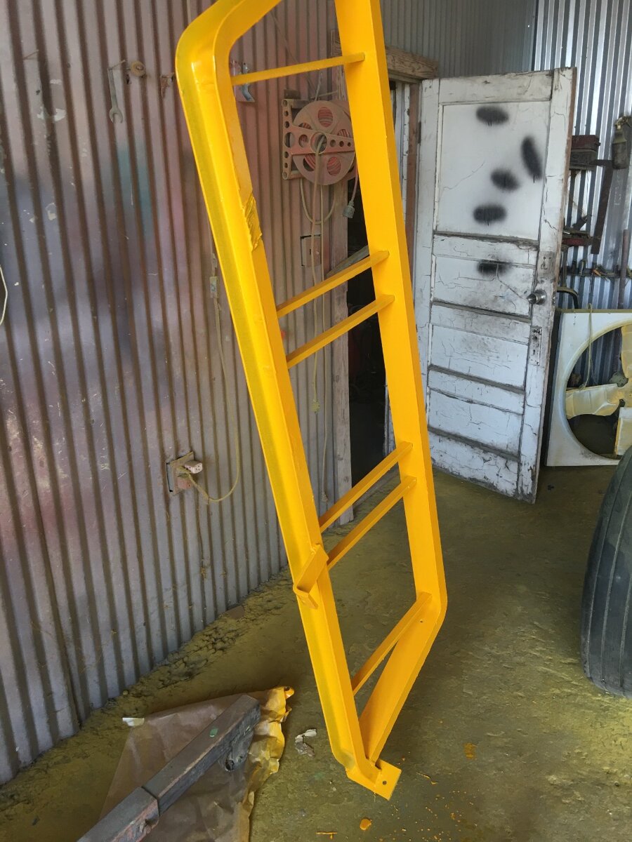

Farmall1066 Posted October 22, 2020 Share Posted October 22, 2020 That industrial yellow is sure looking nice Tony!!! This is your project, and I’m sure your getting excited, but I’m sure getting excited for you!! I can’t wait to see this thing complete!!!! ????????????? 1 Quote Link to comment Share on other sites More sharing options...
Tonyinca Posted October 22, 2020 Author Share Posted October 22, 2020 2 hours ago, Farmall1066 said: That industrial yellow is sure looking nice Tony!!! This is your project, and I’m sure your getting excited, but I’m sure getting excited for you!! I can’t wait to see this thing complete!!!! ????????????? Thank you sir ! yes ,color is growing on me , I am used to being a IH red Guy . Seems so different doing IH yellow . Lol yes , it’s been a long time cleaning rust grease and repairs galore . I think I am doing one of last machine shop repairs as of today , four new brass bushings and four brass washers . For the Auger system . when baler comes back from painting I’ll be so excited to start The building process. tony 2 Quote Link to comment Share on other sites More sharing options...

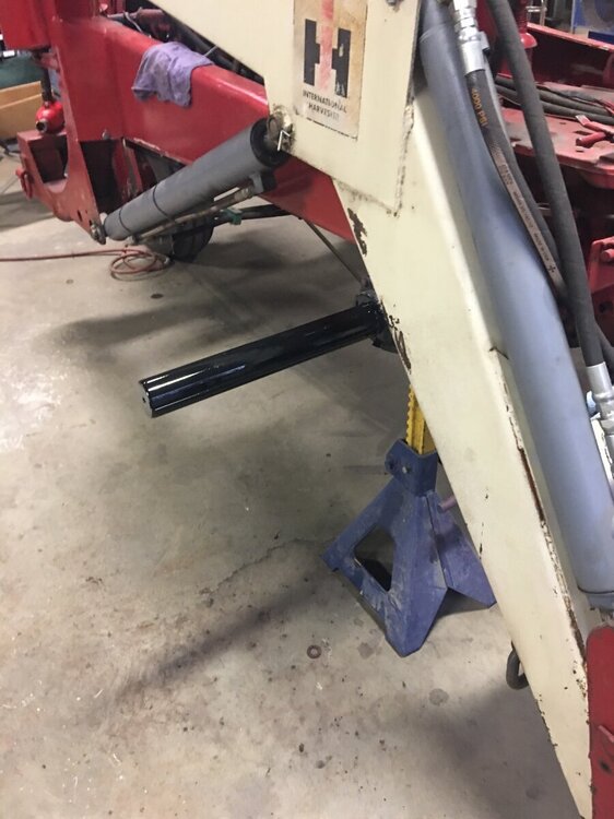

Tonyinca Posted October 28, 2020 Author Share Posted October 28, 2020 10/27/20 worked on a interim project while waiting on baler painting I have a Farmall 350 LP reverse loader that I have had for six years , she was a MN girl used for feeding cattle for it owner and designer till he passed and I purchased from his estate . I have had a set of good wheels and rims to replace cracked and welded cast on wheels . Had these painted and waiting for three years but other projects took precedent. yesterday, I started and today got axles ready for paint . hope to have new wheels and rims on tomorrow and ready for new set of tires . tony few pic’s ; BTW wheels pretty dusty from waiting so long !lol 2 Quote Link to comment Share on other sites More sharing options...

Tonyinca Posted October 29, 2020 Author Share Posted October 29, 2020 10 hours ago, twostepn2001 said: Tony, looks like you replaced or re-did the steering column on the loader tractor....? Yes , Been working on Her off and on last several years . He originally had the old 350 dash board welded to the propane tank shield . Well first time I took her to a parade something shorted up there and I am trying to Fix it with sparks flying and I said enough of this ! Lol . So ,I built new post and a new dash board and re wired it , all is good now except I need to paint it . this thing purrs like a kitten everything works well but it need a little TLC yet I am trying to leave it as original as possible as it came from feed lot. had to make a new bucket , the original was pretty well used , abused , and old . ill get you a better pic of dash board . tony 1 Quote Link to comment Share on other sites More sharing options...
Tonyinca Posted October 29, 2020 Author Share Posted October 29, 2020 10/28/20 Baler therapy Wednesday , working on Farmall 350 loader . John and I mounted the new wheels and Rims . either we are really getting old or it’s harder then it looks ! Man , we were both shot when done . Lol tony few pic’s 3 Quote Link to comment Share on other sites More sharing options...
Tonyinca Posted October 29, 2020 Author Share Posted October 29, 2020 10/28/20 being its baler therapy Wednesday , after we finished the wheel project in above pic’s , John and I paid David the painter a visit ,had to have our baler fix For the week .! lol . its basically all primed , that is yellow primer , He has few items to touch up then He starts shooting final color . if all goes good perhaps next week she comes home. Powder coating is doing final pieces I took them, David has done all the final small pieces I took to him along with Baler. machine shop has auger drive for making , tighter Four brass bushings And making four brass washers. I ordered the generator belt and at this point only thing that I know I need is a breather filter for the hydraulic pressure cylinder. Hopefully will only need whatever incidentals that will pop up . tony few pic’s 2 Quote Link to comment Share on other sites More sharing options...
