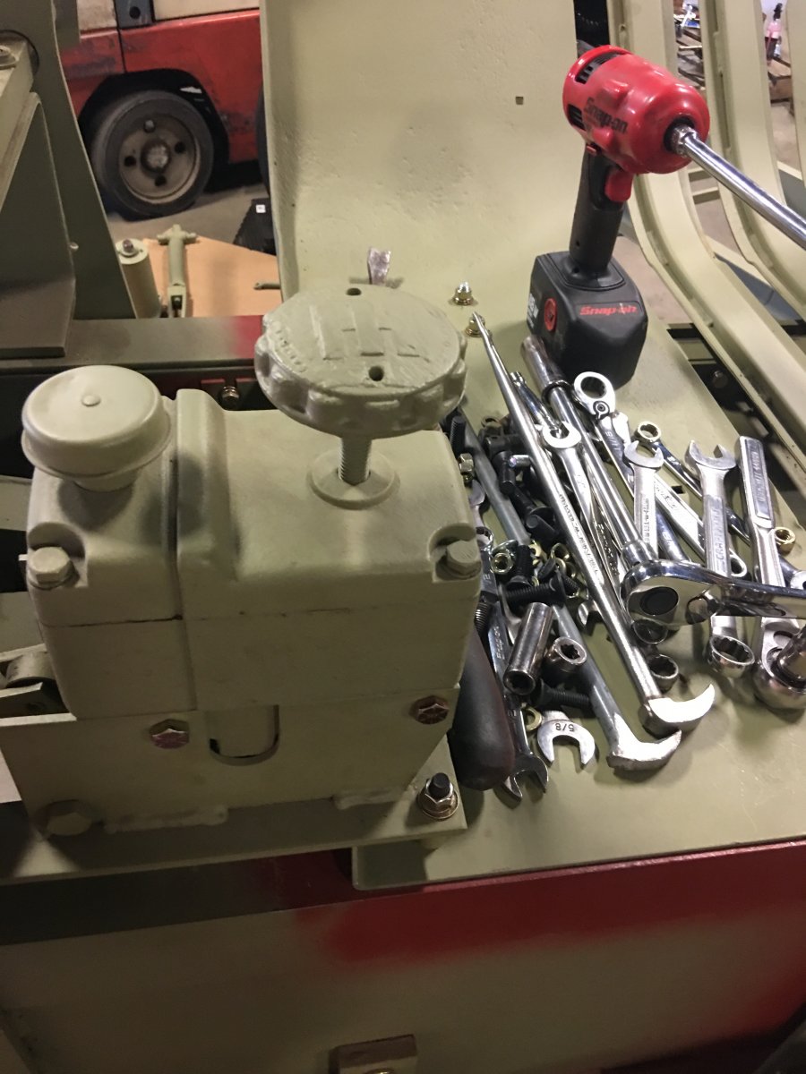

Baler therapy Wednesday !
good day , the knotter system is all together and going through hand driven motion seems well .
we need to replace knotter base but this Is a great step , was worried of getting shims where needed and getting the trip dog in proper operating mode , so far so good

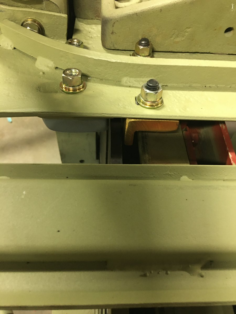

we used a porta power to press top of feeder house tin into proper position for the plunger guides .obviously fork hit it in its past life.
Also to set twister mechanism where it is perfectly lined up had to use A come a long on left side plate And position shims where needed. It all seems to line up nicely now .
we moved forward with knotter in place and it was put through cycle by hand and it seems to be functioning correctly. Albeit will need a lot of timing measurements as we go along .
