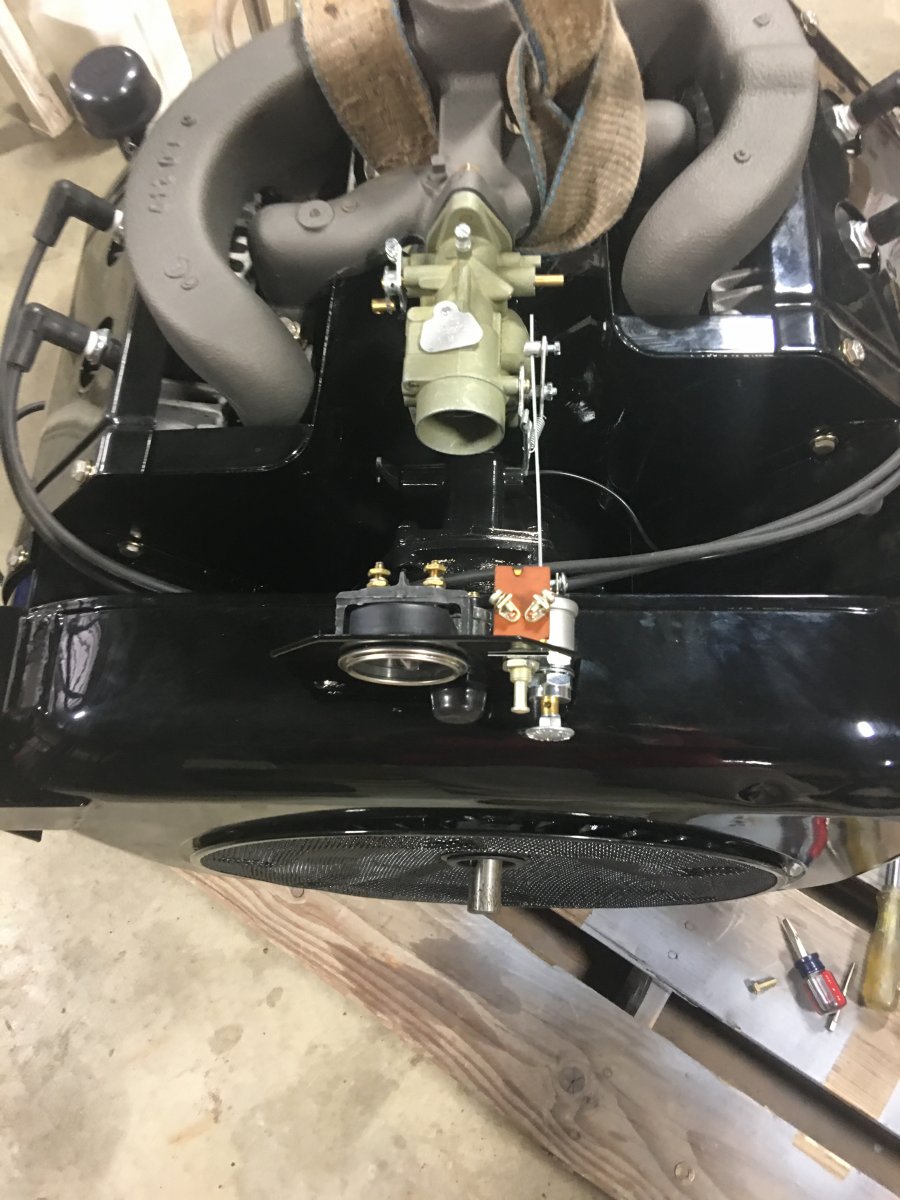

Engine coming together  5/21/20
had to make few runs to our local hardware store for stainless and brass fittings fo fuel pump and filter
finally ,I think I have anything that harbored rust , off and blasted.
only thing we have not touched yet is the pickup reel. But I am hoping that we can tackle that last as baler is being painted
Had big meeting with David the painter and he is going to purchase paint and supplies and get started painting. Hopefully his family situation let’s him get er done in timely fashion
tony

      Going back with new Protronix distributor with associated plug wires and coil , Plan to run AV gas in it like I do my other toys , It will be interesting how well it starts and runsB)
  Hope I know how to time this thing , been reading all the manuals.    Funny thing , this is serial 348xxx and is positive ground , 378xxx beyond they are negative ground , I am at crossroads do I want positive or negative ground ?
     Thanks, Tony

Please tell me the in fo on the carburetor ?
The original was a side mount Marvel/Shebler.
   It was pretty much  rough  shape. I searched for parts ,was told they been out of business for close to 50 years.
    Zenith filled the gap , basically same carb but zenith all dimensions same, pretty available but pricy.
     Tony

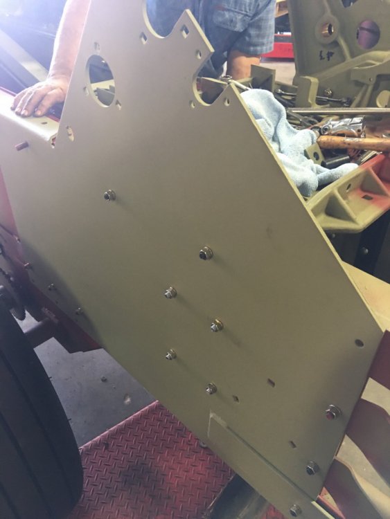

6/3/20
John and I back at it !
all our work is back from machine shop and welding fabricator .
we installed knotter casting and anchor plate .and installed knotter base with that all anchored we proceeded to install plunger knives and began setting plunger to specs . Easier said then done . Had to do a little shims to get our tolerances.
we found one more top plunger guide that was missing , so borrow from donor and need build up.
Our plan is to continue assembly to a point where most of baler can be painted as a unit then paint small pieces as we go.
I can see it’s going to be slow goIng reading manuals and measuring as we go And sometime two and three times ! Lol lolCD9A3DD4-83C4-4E4F-88D4-3DEA5CA760D0.thumb.jpeg.197be36515f1bbe2754d33db406487d0.jpeg
tony

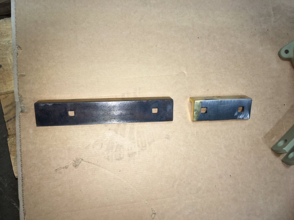

     6/6/20
       Thought we had all rails , runners , guides rebuilt and. done !
        While trying to set plunger today realized there was a plunger guide missing from this machine, A small one but in a critical area of plunger travel.
hard to see because it’s attached under sheet metal on upper rail
         Searched donor out back and  found one .  Wore way beyond useful ,can see where previous owner tried building it up in place with his welder.
         I am hoping its same dimensions as the longer one I had done.

6/11/20
machine shop fast tracked my upper plunger guides.
Now I can button up plunger and move on .
Rest of pieces blasted and primered at this point . Till we reach the pu reel

Had a free day today so spent day in shop working on this  temperamental old girl . :wub:
 By  installing the feed opening or feeder fork tin and installing the newly rebuilt plunger guides, I had to re-align everything , remove shims from stationery knife, etc .
  BooCu bolts involved .  I think I have it .:unsure:
     My arms are bruised and scraped from reaching in chamber  holding bolts while stretching to put nuts on top and using a pry bar to align holes.:o  My wife came out approved of my gymnastics as good exercise, being she is always after me to work out more :rolleyes:
