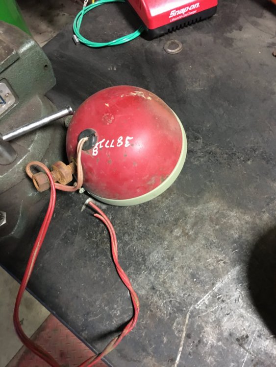

Tonyinca Posted April 17, 2020 Author Share Posted April 17, 2020 This State mandate has really slowed everything. 4/16/20 Fuel tank has been boiled and acid, pretty clean inside knotter parts with any sign of wire grooving has been sent to machine shop for build up and polish Engine sheet metal has all been repaired and powder coated black lights buckets have been powder coated yellow and bucket leads purchased from Brillman ,waiting on sealed beams from Stiener Engine should be out of machine shop by first of May. Soon I will begin on pickup reel Been taking inventory of brackets, trinklets ,needed and sourcing them from the donors When John comes back we should be able to hit it hard in going back together, I think I have 99% of components ready for install. Tony 2 Quote Link to comment Share on other sites More sharing options...
