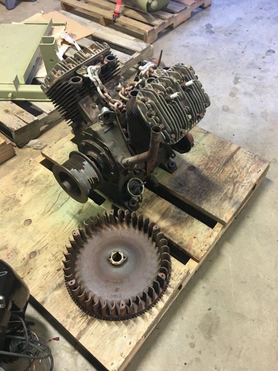

Tonyinca Posted March 12, 2020 Author Share Posted March 12, 2020 4 hours ago, exSW said: Anything special about rebuilding a Wisconsin? Actually a simple engine, However, parts are scarce and they have their ideocracies . This engine was not stuck, per se , It was dauber mud nests packed behind flywheel and every crook and cranny. Tony 1 Quote Link to comment Share on other sites More sharing options...
Tonyinca Posted March 12, 2020 Author Share Posted March 12, 2020 Few of knotter gears will need machining, Wire strippers & wire twisters need building and polish Tony Quote Link to comment Share on other sites More sharing options...

Tonyinca Posted March 28, 2020 Author Share Posted March 28, 2020 3/28/20 Wisconsin engine is at Machine shop. Engine sheet metal being repaired and sent to Black powder coat Been shopping internet for Wisconsin engine parts on line , Going protronix new distributor , Marvel Schebler carb been replaced by Zenith all seem dimensions, Found Nos switches , gauge, muffler , gaskets ,etc Its been slow and difficult with quarantine state order in place but I keep chipping at it. I am worried about painting my painter is health care provider for his brother who's had several strokes , David cannot take lightly many risks with C- virus Hoping I can have engine done and all parts available ready to go when machine shop is done. Tony 1 Quote Link to comment Share on other sites More sharing options...
Tonyinca Posted April 8, 2020 Author Share Posted April 8, 2020 Engine taking 30 over to clean up . New pistons, Valves , seats. Two valves had to be cut off because they were bent , must of been stuck at some point. Crank had to be put under 50 ton press to get drive pulley off . Tony 4 Quote Link to comment Share on other sites More sharing options...
