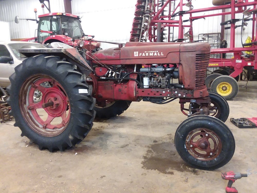

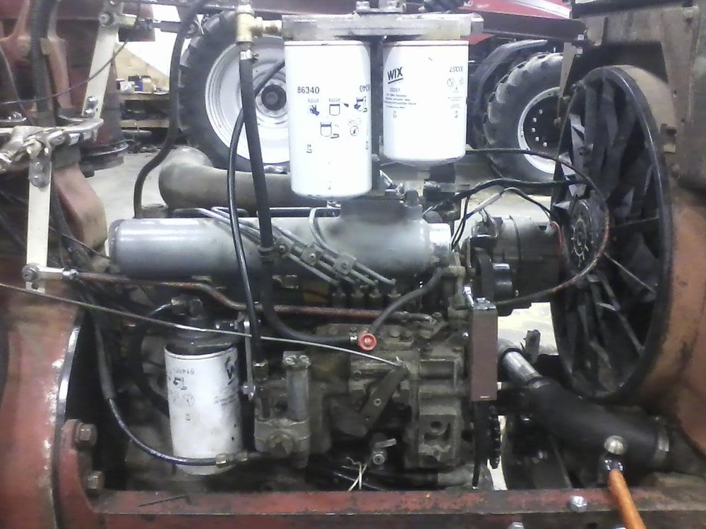

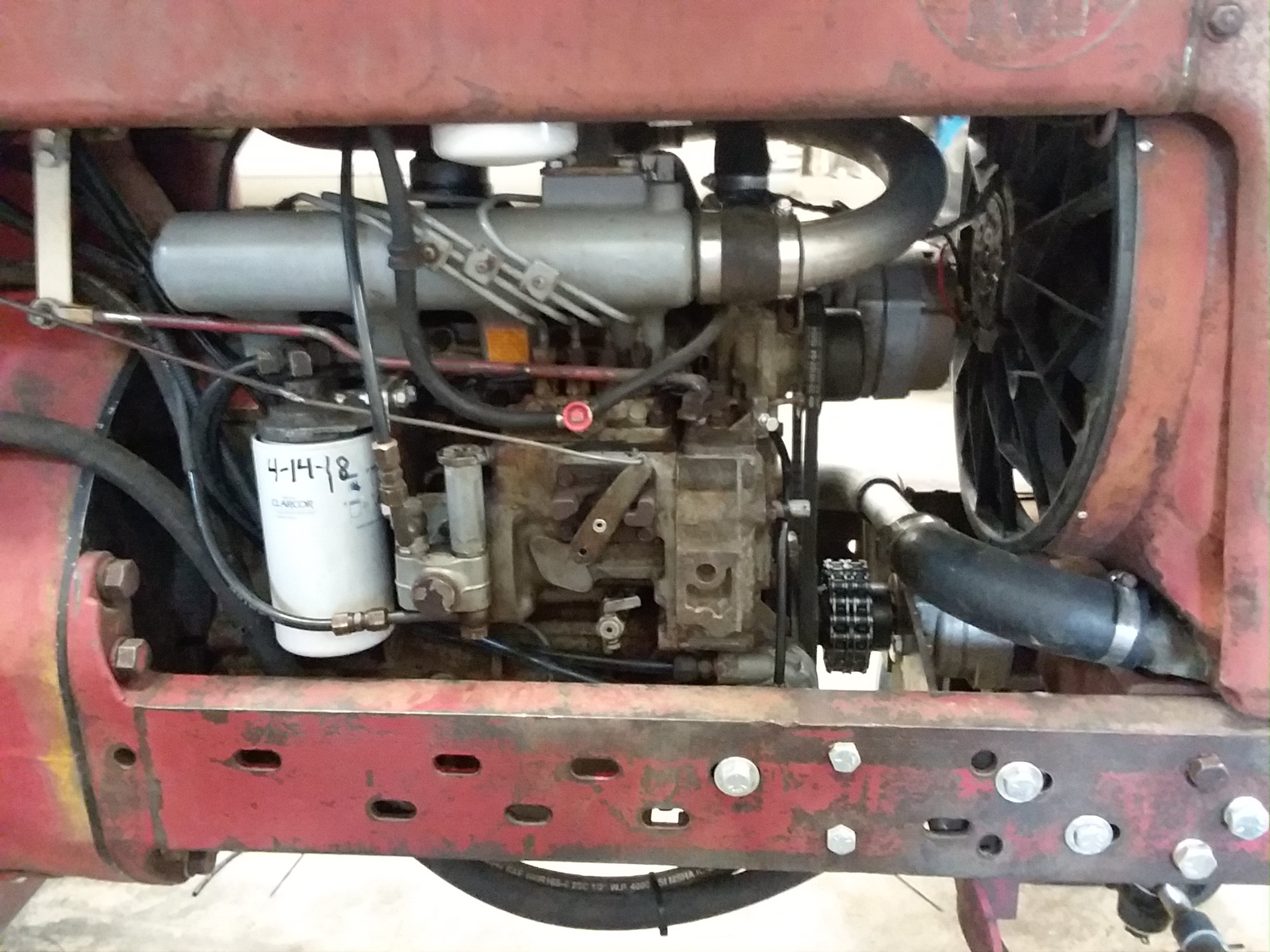

DolanVDS Posted August 19, 2018 Share Posted August 19, 2018 I am a junior in high school and have been working on a tractor for my FFA project. I have put a v2203 Kubota diesel into Farmall Super M. I also pit an m&w 9 speed in it out of a Farmall M. I also upgraded the hydraulic system to a 2 spool live system. I am still working on a lot of little things before paint comes, but I wanted to see what you guys thought of it. Feel free to ask questions.I am still working on a lot 1 Quote Link to comment Share on other sites More sharing options...

Stan003 Posted August 21, 2018 Share Posted August 21, 2018 What Kubota motor did you put in it? Thanks, Stan Quote Link to comment Share on other sites More sharing options...
DolanVDS Posted August 21, 2018 Author Share Posted August 21, 2018 33 minutes ago, Stan003 said: What Kubota motor did you put in it? Thanks, Stan It is a Kubota v2203di 4 cylinder out of a refrigerator trailer. Quote Link to comment Share on other sites More sharing options...

Matt Kirsch Posted August 23, 2018 Share Posted August 23, 2018 I bet it's fast. The Kubota runs at 2800RPM. I know you can idle it back but it doesn't put out a lot of power at lower RPMs. With the 7MPH 4th gear, I'll bet it'll do 10 in the field easy. Nice raking tractor. Quote Link to comment Share on other sites More sharing options...
DolanVDS Posted August 23, 2018 Author Share Posted August 23, 2018 1 hour ago, Matt Kirsch said: I bet it's fast. The Kubota runs at 2800RPM. I know you can idle it back but it doesn't put out a lot of power at lower RPMs. With the 7MPH 4th gear, I'll bet it'll do 10 in the field easy. Nice raking tractor. It will do 30 mph in 5th gear. The 9 speed put a a grat between 4 and 5 and is about 18 mph. 4th gear is right around 11 Quote Link to comment Share on other sites More sharing options...

augercreek Posted September 4, 2018 Share Posted September 4, 2018 A very nice job there young fellow! But please don't use pipe fittings in your hyd. system, they can break and are not rated for more than a few hundred pounds of pressure. I know from experience. Quote Link to comment Share on other sites More sharing options...
