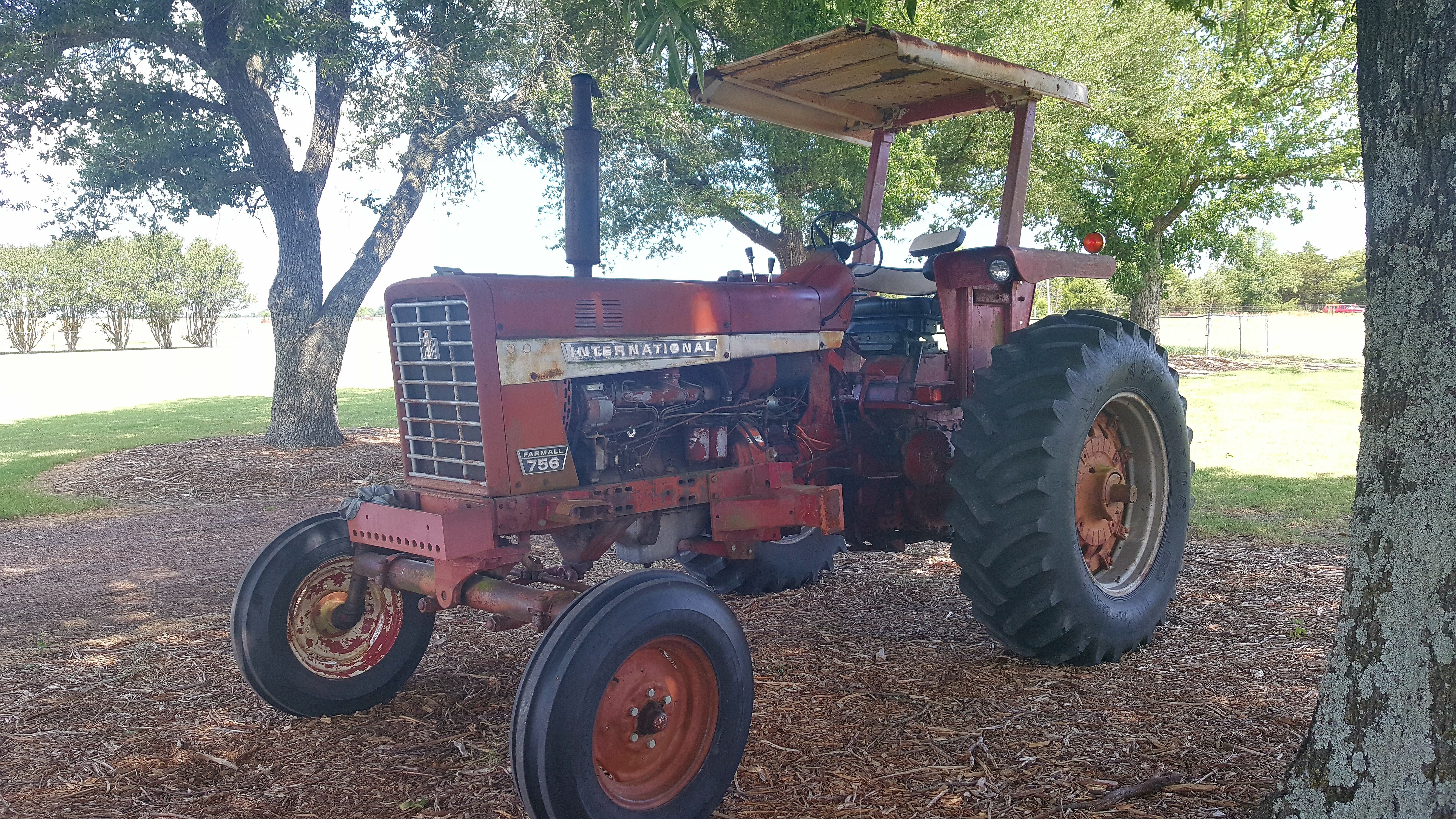

After i got it home i noticed a few things. Someone moved the 55 series loader brackets way back and mounted them to frame rail and clutch housing like the 50s should have been. It sits back farther than it normally should but i like where its at. I have some 8 bolt hubs and 10.00s ready to go. These 7.50x18 are odd duck wheels and tires. Wish they were 8 bolt, even more rare. Guy i know i already screaming at me to swap my 34s for his 38s. Kinda like how i dont have to step up on this 756 as is. Pto brakes are shot. Fender lights work. I was more amazed about that fact than the front end was tight and unwelded. Need to find a bucket for it. Think my cih 2350 bucket has the fixed mounts. Have seen some that are adjustable.

Never seen an inline fuel cut off untill now. Unplugged it to see if it works and it killed it fairly quick at 1/3 throttle.

Looks nice and straight. Canopy is a nice touch in my opinion.

I know it, but its very rare to see a true factory 56/26 series rops w/fenders. Its alot easier to put rops fenders on brackets than it is bracket fenders on rops. They do not interchange quick and easy. Im thinking of pulling it off and put open station fenders on it.

Unless you plan to put this in a museum, I'd say safety first, leave the ROPS in place.
