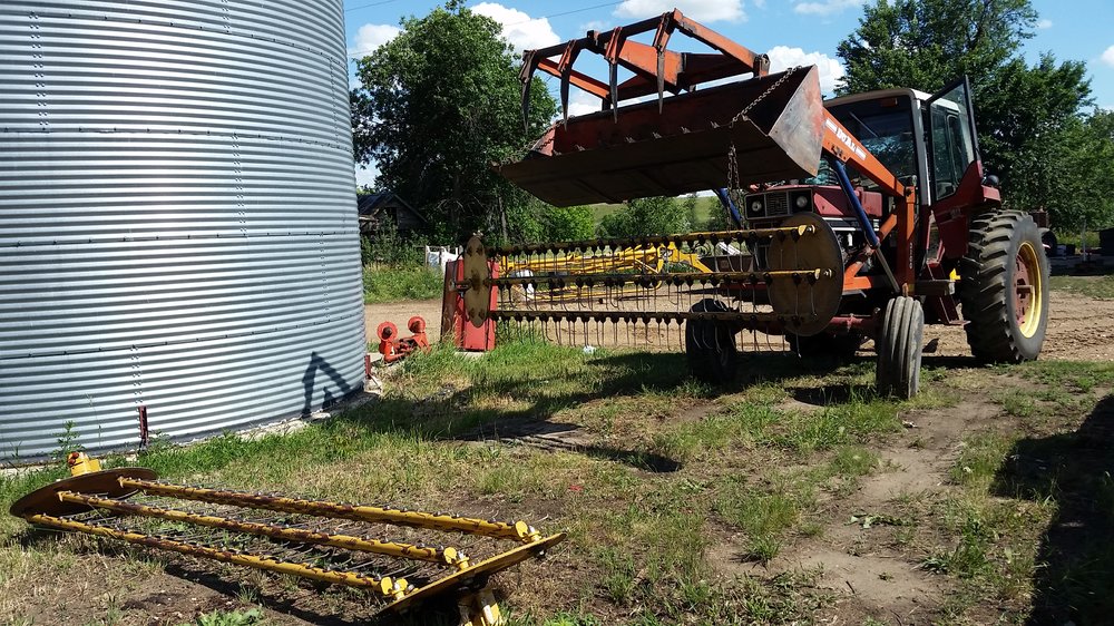

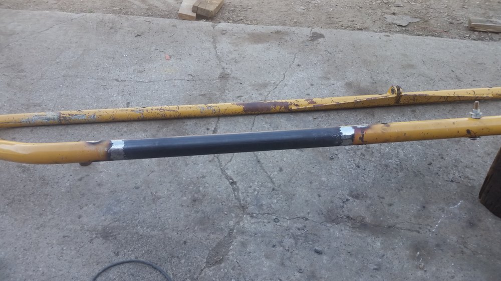

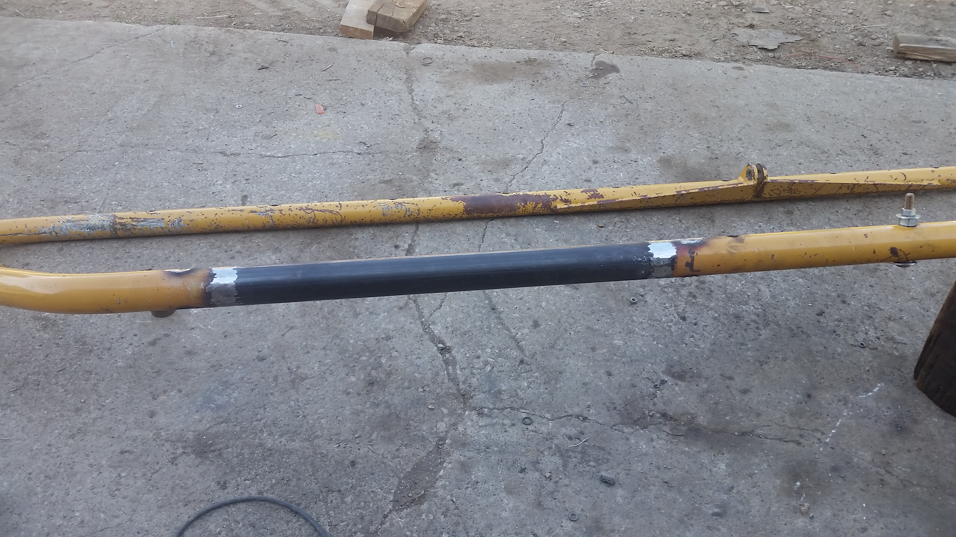

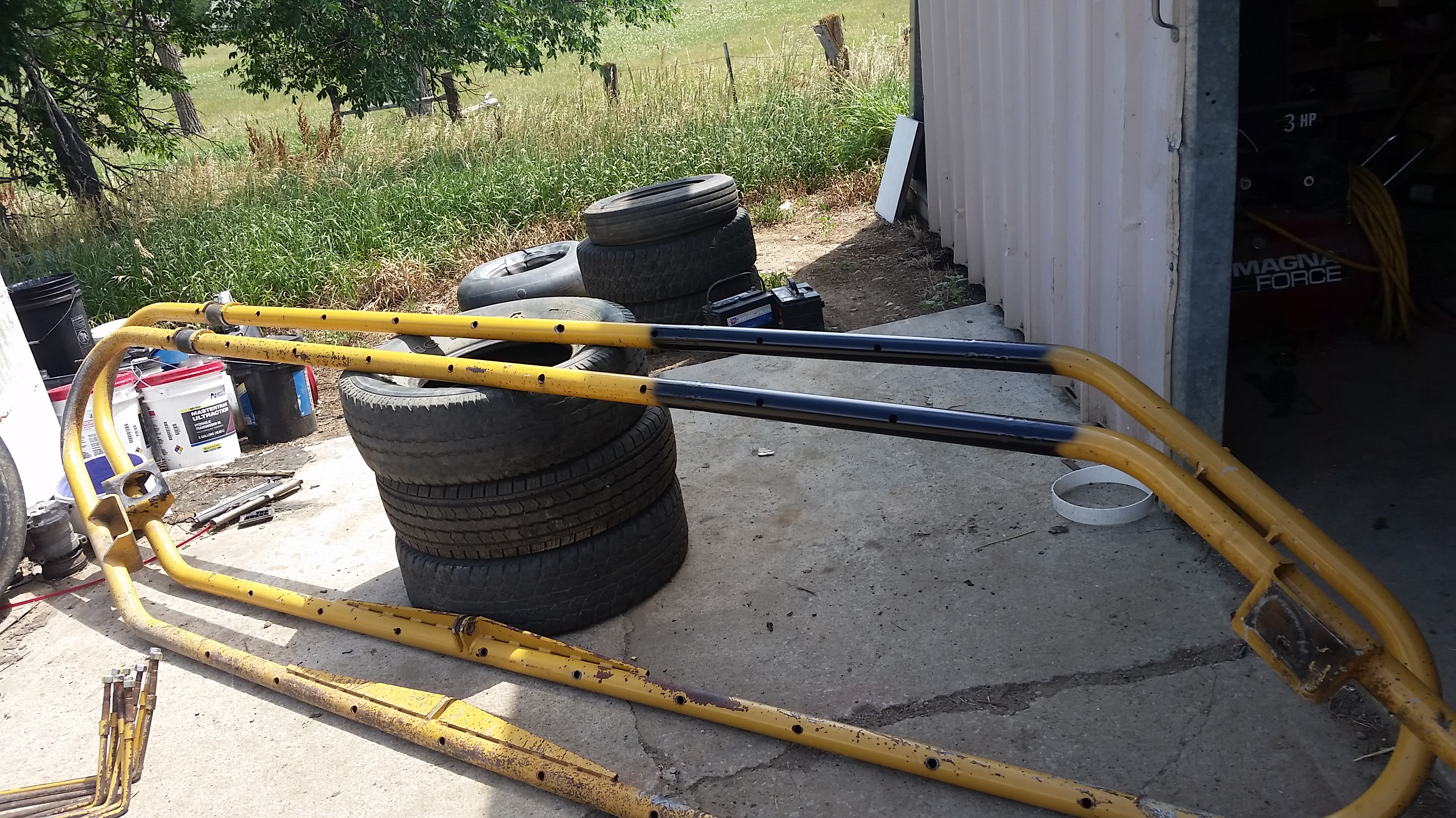

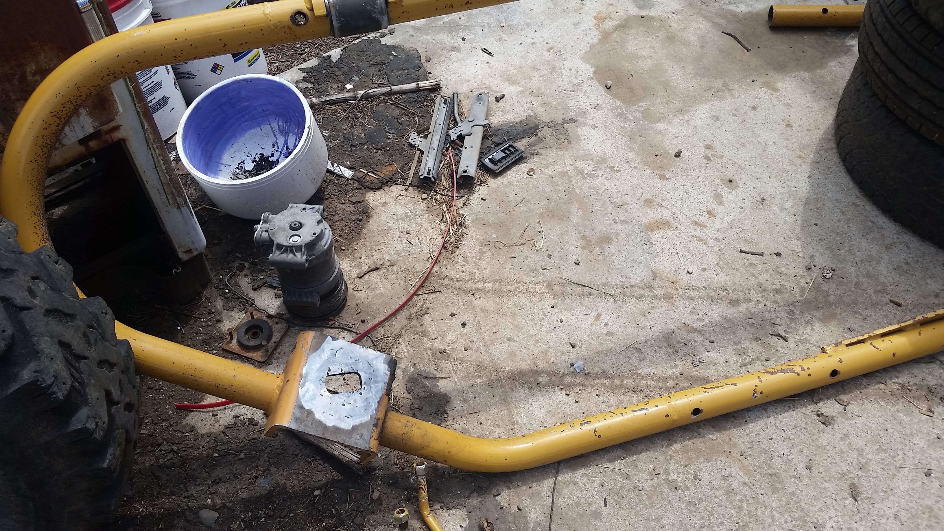

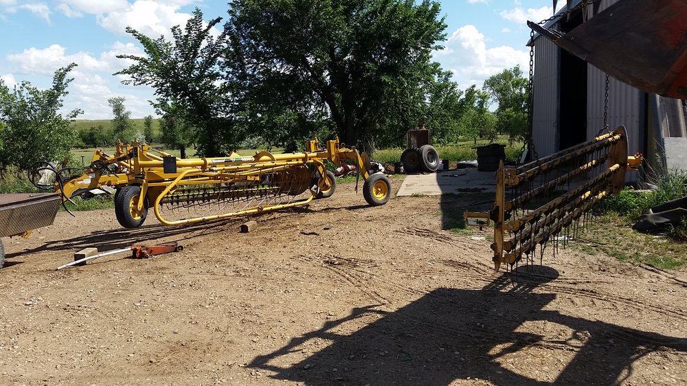

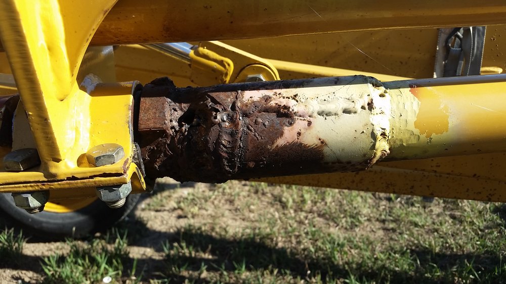

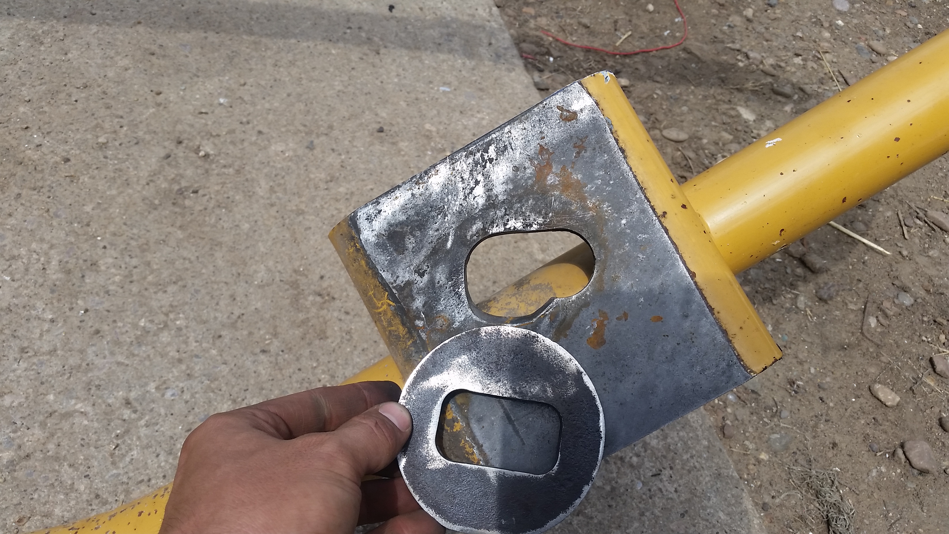

I have been wanting to upgrade to a driven rake from my wheel rake and I got a deal last fall on this vermeer rake that had been rode hard and put away dirty. Both basket frames were broken and poorly repaired and the slots that the baskets mounted it were wallered out from lack of grease and bushing wear.  I cut the bad chunks of frame out and replaced them. I also put a smaller piece of pipe inside the repaired area to stengthen the repair. Then I used a hole saw to cut out the damaged mounting point and had a neighbor mill new slots in some circles I cut, then welded them in place.  It took a bit of time to do these repairs but I'm happy with the results. I figure I saved $5,000-$10,000 over buying a better, but still used rake.

The R2300 is hydraulic fold, the R23 and R23A were manual.  Very good rakes.  I like them better than a high capacity wheel rake for pretty much everything except corn stalks and high volume oat hay.  The key to making these rakes work well is to play with the tilt of the basket with that threaded rod on the back of the basket, and to play with your ground speed.  Seems like 6-8 mph is the sweet spot.
