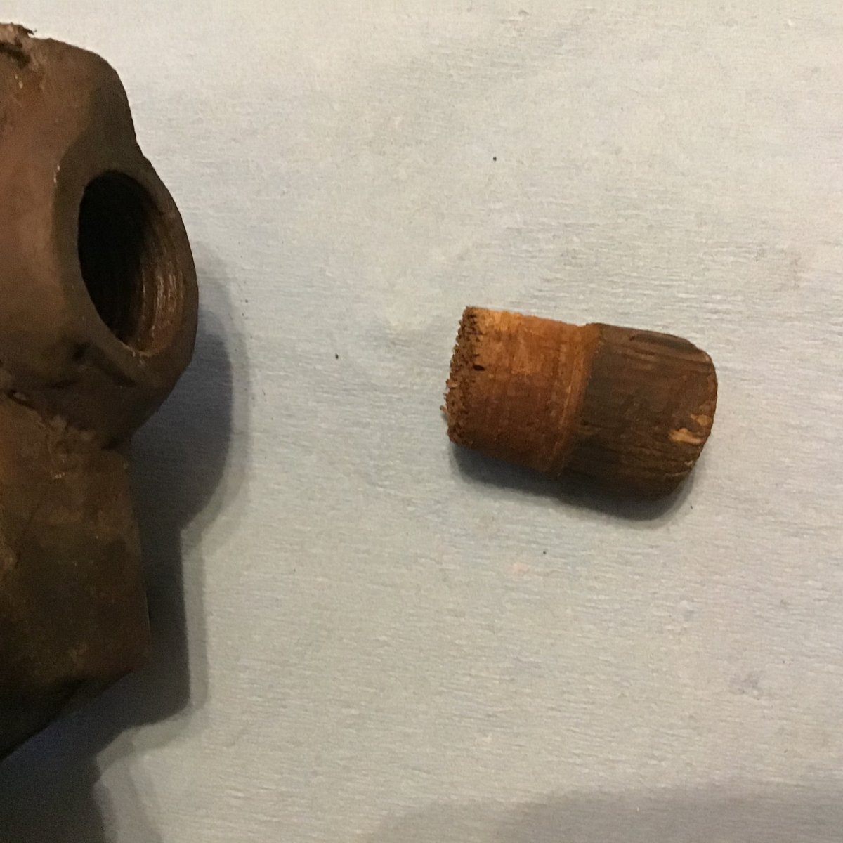

560Dennis Posted December 14, 2019 Author Share Posted December 14, 2019 Working on the 234 Holley Float assembly . I discover that I have a masterpiece of ingenuity, of most likely Great Depression influences motivation. Looking close at the construction of the nozzle cap ,and the needle sleeve. They are made of wood. They are hand ? made and I’m confident that they must have worked . The float was missing when I got the vaporizer, it maybe been made of wood , don’t know . I got the vaporizer from a local fellow ,he said he got it In Canada ?? . So I better get more details when I visit him to get the replacement float. I never notice the valve , I thought it was just stripped , but when it came out. I just had to take the time to marvel at the determination of the farmer ?? to get this tractor operating. Looks like the valve retainer was made with a pocket knife ❓ l wish I knew more about who did this . please comment . You ever thought or seen anything like it❓?♂️ Quote Link to comment Share on other sites More sharing options...
sugarmaker Posted December 16, 2019 Share Posted December 16, 2019 Dennis, Glad you found your vaporizer. Wooden parts in a old antique carb? Never heard of such a thing? As you say they must have been desperate to get a tractor functioning! And if the parts were close to being the right shape, maybe it did run pretty well? You know gas is not that smart, to tell if its wood or steel! Regards, Chris Quote Link to comment Share on other sites More sharing options...
560Dennis Posted December 17, 2019 Author Share Posted December 17, 2019 5 hours ago, sugarmaker said: Dennis, Glad you found your vaporizer. Wooden parts in a old antique carb? Never heard of such a thing? As you say they must have been desperate to get a tractor functioning! And if the parts were close to being the right shape, maybe it did run pretty well? You know gas is not that smart, to tell if its wood or steel! Regards, Chris Actually that wood needle valve still has an excellent fit , if I can’t find one I’ll use it . ya depression engineering at it best . And it worked Quote Link to comment Share on other sites More sharing options...
