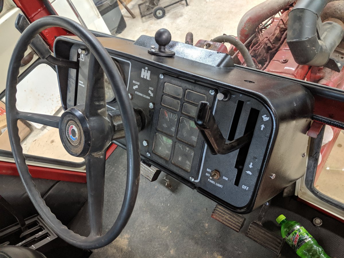

gafarm49 Posted June 12, 2019 Author Share Posted June 12, 2019 Finally getting back on it a little bit. Got the dash done and everything works. I carried the hood panels to a sandblaster guy. They look like they had been painted at least 3 times with a different shade every time. I went to do the exhaust and the elbow was just too thin, so a new one is on the way. I'm lining up the AC parts as well. I just don't have alotta time to work on it with crops and 12 chicken houses. Everything really got dusty since I last messed with it Quote Link to comment Share on other sites More sharing options...
