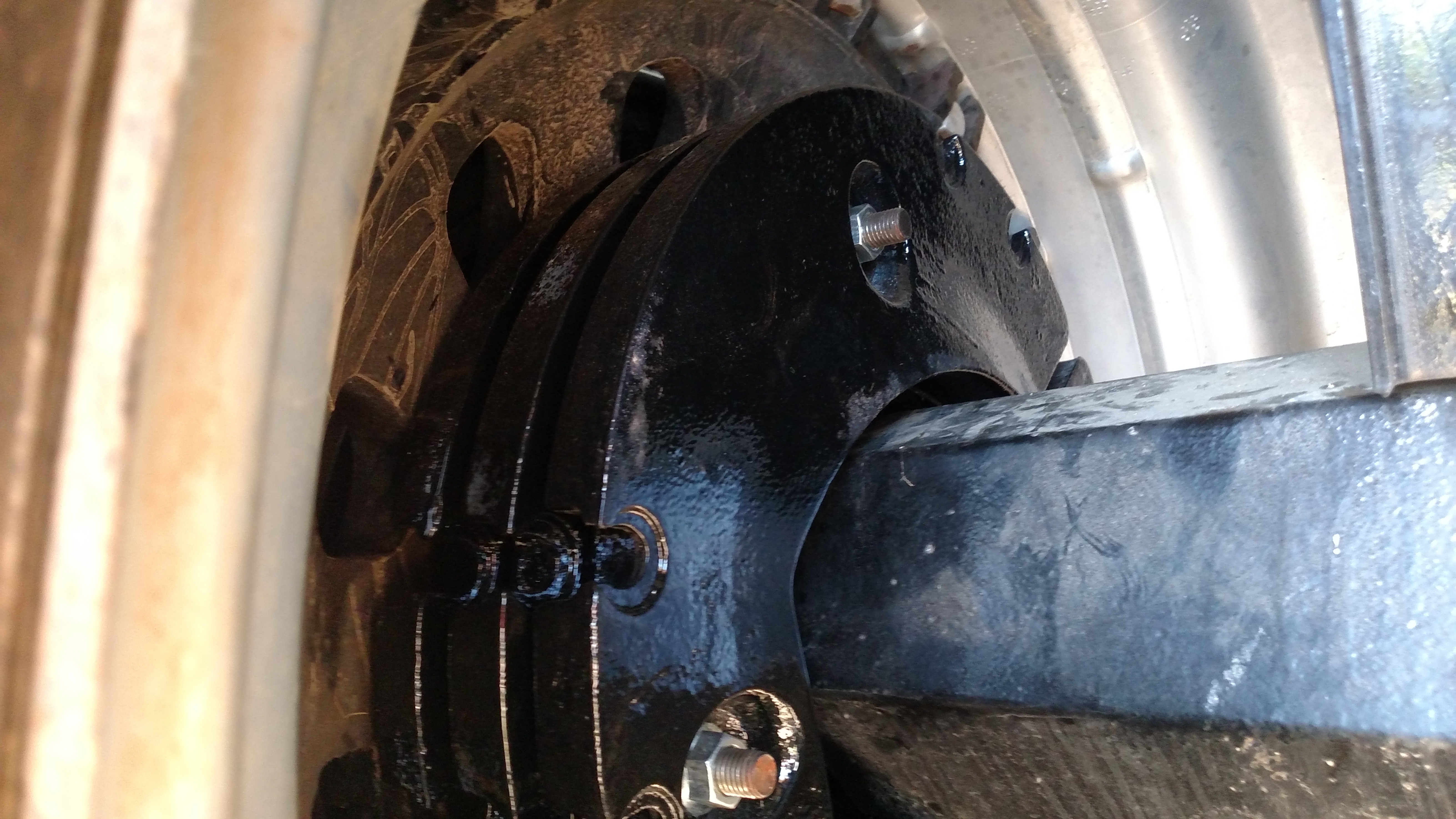

superih Posted September 25, 2017 Share Posted September 25, 2017 I've fought power hop with my 5488 since I've owned it, been all over with tire air pressure to make it the best I could but with the rear tires not filled with fluid I simply needed more weight on the back of the tractor. So, this was my project yesterday while enjoying the 92 degree heat here in Central Michigan, ugh! We sweat our butts off, pulled the duals, dual hubs, then slide the main wheel out, added these wheel weights to the outside that weigh 950 lbs each and also put 3 sets of split weights on the inside of the wheel, then slide back in and started tightening wedge locks down. Took two of us around 4 hours to finish the job on both sides, adding a total around 2700 lbs to the back of the tractor. Link to comment Share on other sites More sharing options...

superih Posted September 26, 2017 Author Share Posted September 26, 2017 2 hours ago, Thesd5488 said: I have a set of those big weights and eight sets of wheel weights with cast 20.8-42 duals I don't use the front wheels much any more tractor weighs 26700 Got any pics of that set up? I would have liked to put the big ones on the inside, not sure if they would have fit the dish of the wheel though. It looked like 4 sets of splits on the inside would have been too close to the axle housing too, so it looks like this is as much as I could hang on it. Link to comment Share on other sites More sharing options...

Thesd5488 Posted September 26, 2017 Share Posted September 26, 2017 10 hours ago, superih said: Got any pics of that set up? I would have liked to put the big ones on the inside, not sure if they would have fit the dish of the wheel though. It looked like 4 sets of splits on the inside would have been too close to the axle housing too, so it looks like this is as much as I could hang on it. My big weights are on the inside they make the split weights that are for the 88 series they have a bigger center to go over the axle housing I have one weight on outside of inside wheel and seven sets on outside of dual Link to comment Share on other sites More sharing options...

superih Posted September 26, 2017 Author Share Posted September 26, 2017 Your inner cast must be dished in then? Mine is dished out and set as tight as I can to the axle housing to make it down 30 inch rows. I have the 88 style splits, I made a cardboard template of them and they got real close to the axle housing once I got over 6 inches past the end of the housing, like less than 1/4" clearance so I only put 3 sets on instead of 4. Looks like your 5488 runs real hard, mine is only set at 220 horse right now. Link to comment Share on other sites More sharing options...
Thesd5488 Posted September 26, 2017 Share Posted September 26, 2017 Mine are dished in only way I could get cast duals to work I just like looks of the cast Link to comment Share on other sites More sharing options...
