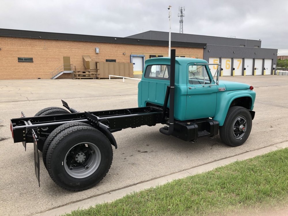

Sask466 Posted June 27, 2020 Author Share Posted June 27, 2020 9 1 Quote Link to comment Share on other sites More sharing options...
SMOKER 1 Posted June 28, 2020 Share Posted June 28, 2020 That there is one sharp truck.??? jerry Quote Link to comment Share on other sites More sharing options...
jingles1928 Posted June 28, 2020 Share Posted June 28, 2020 If you didn't know better you would think that was factory. Nice job Quote Link to comment Share on other sites More sharing options...
exSW Posted June 28, 2020 Share Posted June 28, 2020 Wow! Wow! Wow! Quote Link to comment Share on other sites More sharing options...
Mr. Plow Posted July 1, 2020 Share Posted July 1, 2020 Very nice.....IH meets FoMoCo.....both my favorites!!!! Quote Link to comment Share on other sites More sharing options...
