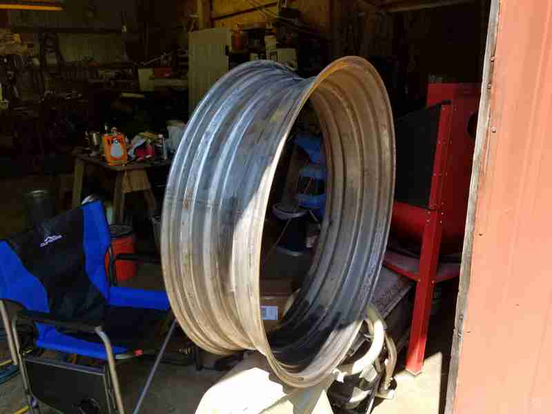

fbh31118 Posted July 12, 2017 Author Share Posted July 12, 2017 The rims are my first prime and paint project. Quote Link to comment Share on other sites More sharing options...
