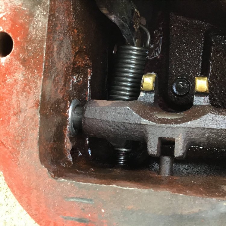

  3. Wanted to take up all the free axial motion of the control valve lever with something. So while at the hardware store I got , 1/2 nylon 40cents washer for outside lever shaft . A 1/2 inch wave spring washer 99 cents. And bronze thrust bearing for $1.05  This prevent the lever from moving the retainer lever off the governors stop.
    I got little over 5 bucks in this ,cause you can no longer get time seven a spring washers .
    i think you can fix the wear on all the governors,with a little braze , ,new available parts. And off the shelves hardware store parts.
    I also think with a map gas torch although I didn’t, a bottle of map gas and a small file set recreate the oem parts.
    I would recommend that you can save these old governors with some effort. Good luck ?
  4. Been working on this awhile brazing up wear points. These parts are not available, so why try to fix them.
    This what I thought about for awhile. Because the spring failed ,it was wearing into rockshaft lever off to the side not giving a very stable purchase. I went to the hardware store and got a thinners rivet that fit into the bumper spring and red loctited in . I saw where one of the other governor has a flat head machine screw in it,. So I copied it cause I thought it was a idea.
    let me know what you think?
    I hope this helps when your redoing your govener. Maybe ?‍♂️

  6. Brazed up the wear in the rockshaft lever and the valve lever. I must missed the wear on valve lever where the return spring wore . out of acetylene , just fill it must have leaked ugh !
    I had to hand and dumper the blends on rockshaft to as close as it could get to match the 5/32 radius. ?‍♂️ Way way better than before.
    get all this wear spots fixed and this Governor should make the C come alive.As much wear as I’m finding ,it a wonder that the Governor would work at all.

  8. Got it all apart and the I’m surprised with all the worn out parts it ran so good . Still glad I opened it up to look. Photos might be of help as to all the wear.
    This needs
    a. New shaft
    b. Braze up wear on the lever
    c. New shaft bronze bushing.
    d. 2 bh-68 melded bearing ,
    e. New springs
    f. New trust bearing
    g. New felt dust seal .
    h. New bronze bushing for the speed control lever.
