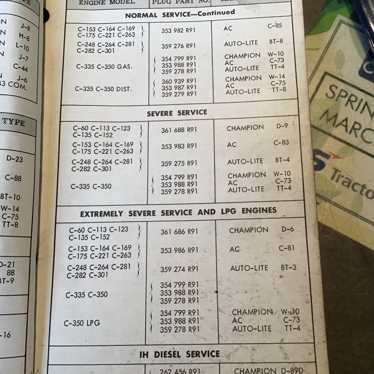

  9. On 6/4/2020 at 10:00 AM, Brews4me said:
    Ok, What the heck is the size of the spark plug???
    Went down to work on this and my 13/16 spark socket is too small.
    Guess in tractors, everything is bigger!
    Use 7/8 box end wrench if you use a 7/8 socket it will not reach ,it will be restricted by clearancebewteen head and plug. Have to turn a long 7/8 down on a lathe.  A Champion Spark plug D16 is a 18 Mm thread  , The NGK A6 plugs have a nice hex ,it’s 13/16 More standard .
