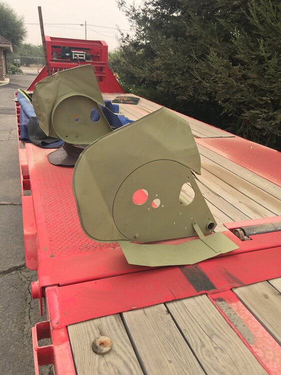

    NOW ! Here is what I got !,smashed tin work
    going to need to become a sheet metal worker real soon .
    green One is blasted & primed we think we can cut better tin pieces from donor and weld them on here and work them over and look decent . If we can overcome that challenge , then next will be getting this thing all together , then the big one will Be , Will  it actually bale hay ? Lo

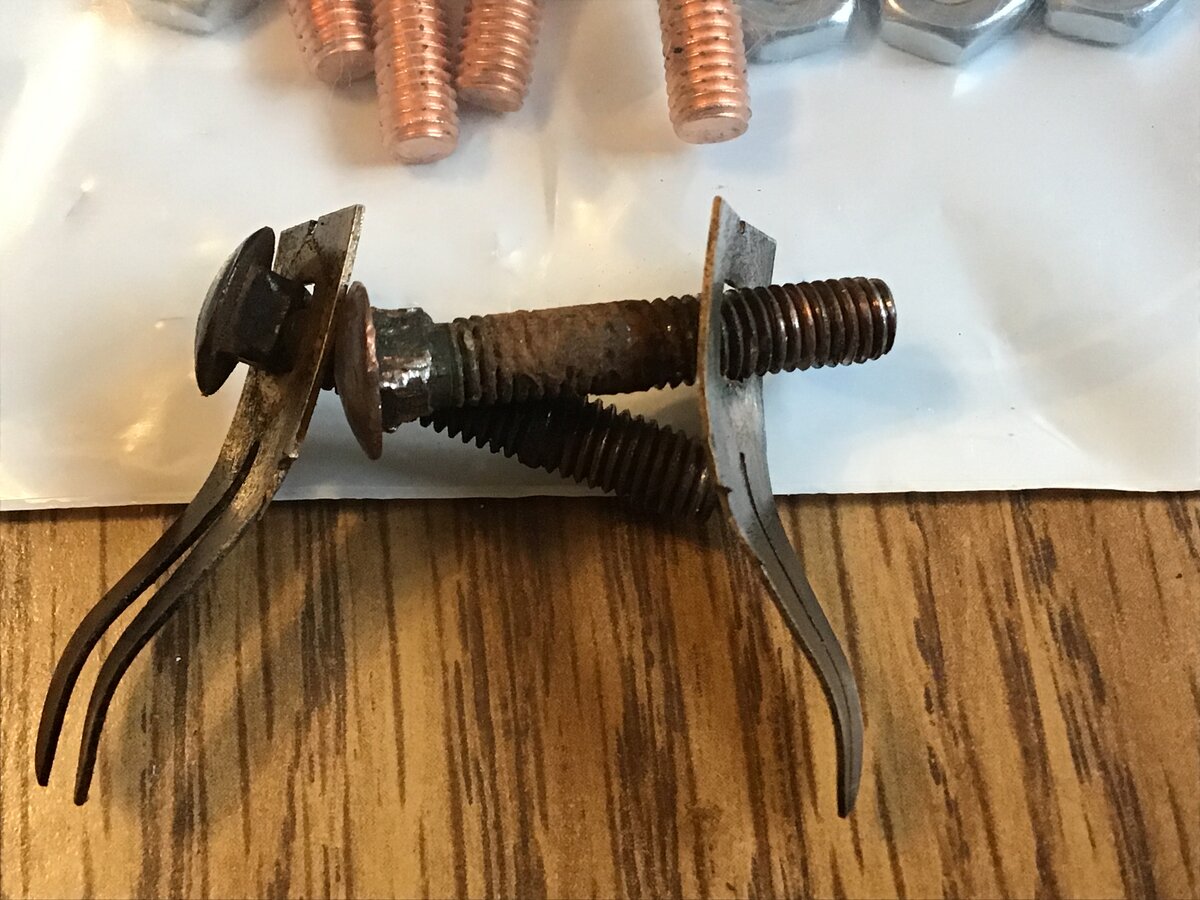

  7. Working on the coil box . Bought one to refurbish from Tony’s neighbor out in California . It was in good shape. I did break ( thunder) one of the terminals getting screw contacts out ,used epoxy to glue most of the pieces back . It an early sow bean plastic Henry came up with took a picture ,no replacement for these babies . Fordson Two types boxes are little Than model T ,don’t know what only ceramic insulation used longer bolt through firewall.
    Copper plated carriage bolts I had were rusty So Duane Helman told me to take them out and clean ,he said he had a tractor that would not idle . He cleaned them and it ran fine after. So I’m going to do whatever he recommends. But my bolts looked like chocolates ?
    Duane recommendation to get and Anderson timer from Snyder’s antique auto parts in new Springfield Ohio  . so I email don and he had two styles,these are the ones I got . They were $2.95 +$10.95 shipping ?‍♂️????, anyway I got to keep moving ahead on it.
