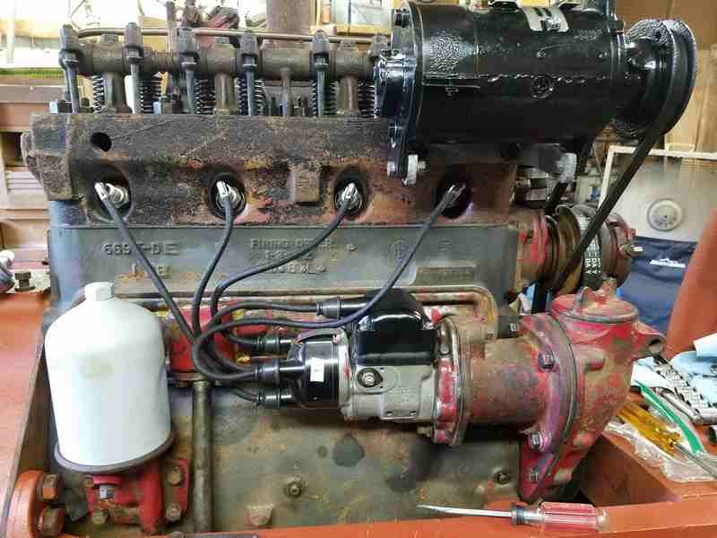

Here is a few more pictures from this week. Nothing earth shattering but as we all know, " The devil is in the details." and there is no shortage of details on this one either. Did run into a snag though, my starter, after starting the engine a few times, began to drag on the ring gear. So, I go to the parts pile and pull another starter off the shelf (that looked like death warmed over), bolted it in and viola, no more drag. That rebuilt starter will be going back to the shop for another look see.

Here is a few more pictured from the other day, hope to get some more done today.
A few things not pictured here that are completed; 1st/reverse shift fork changed due to excessive wear, clutch fingers adjusted, valve lash set up for the first time, thrust bearing for the worm gear replaced, original amp meter saved by the removal of brass nuts.

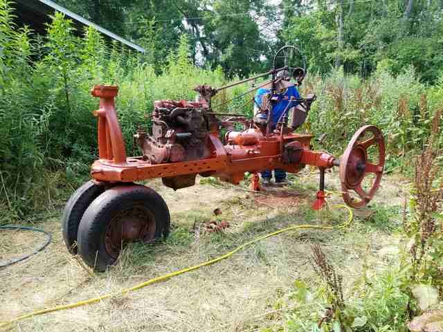

I'm going to start with being functional at this point. I had to change engines due to a crack in the water jacket and the original steel wheels were cut off, so it will never be %100 but I would like to leave a little meat on the bone for later, so to speak. I do have a flat belt pulley for it. This is a family tractor that has been out of use since the late 60's to early 70's so any level of operation would be a God send. My parents are getting up there so it need to get done.

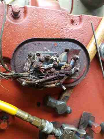

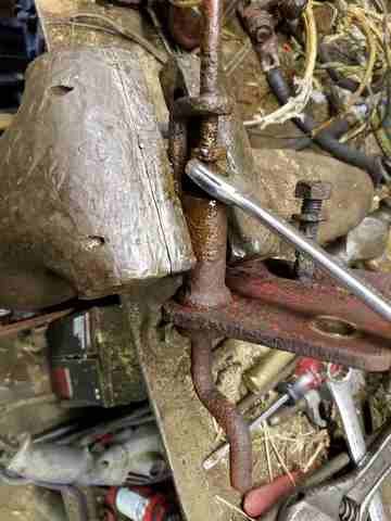

This top picture here just blows my mind. This tractor has set out since the late 1960's or early 1970's and nearly every piece of hardware has come right off. All the bolts on the light bar were this bad and all four nuts came right off. Some of the hex's were so bad that I had to pound a metric socket on to get on and they walked off like nobodies business....... I should be buying lotto tickets or some thing. This can't be the norm by any stretch of the imagination.

Michigan M is correct, they are just stop blocks to prevent the rim slipping. Everybody tried to convince me that the originals were welded in, not true. These were riveted in just like you see in my pictures. The factory probably had a cleaner way of doing it but my way looks original for the outside and wasn't that hard to do. The rivets were ordered from Fasenal and we used a piece of channel iron in the vice to back the rivets. Heat the rivet up with a torch and break out the ball pen hammer and start working it into a head. It really wasn't as hard as I thought it might be and really turns out pretty slick.
