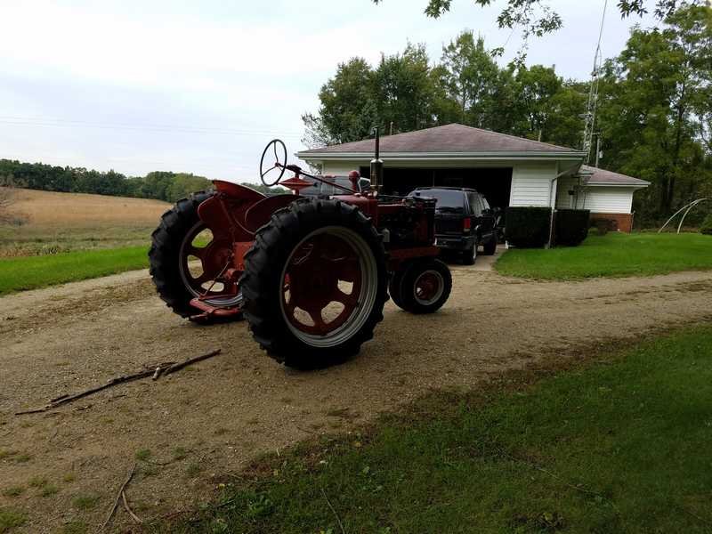

    Did you try testing the temp gauge line in a mug of really hot water? Those new gauges seem to run on the cold , barely get to green sometime. Here's a pic of our H. 1947. Love that tractor and you are doing this job right. Congrats
    Well, I tested it up to 150 the other day.  The pictures above are both brand new gauges, the one in the pod is one I bought last year and the other that is sticking in the top of the radiator is one I bought for my Dads M 10 years ago.  Both pictures are taken at the same time @ 140 degrees.  Just a bad gauge I guess.

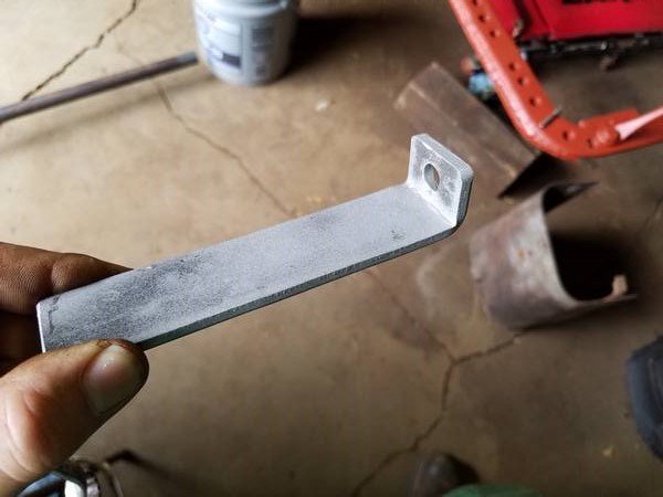

  4. Here is a few from yesterday.
    The brackets for the pto shield are skewed on the left and right for a reason.  The shield was pretty bent up and the original brackets were gone or rotted off so it was centered and brackets bent to fit.  I bought a piece of 1 1/4" flat stock and left the center 6" long because it seems like someone always thinks that they make good steps and they really don't but just in case.

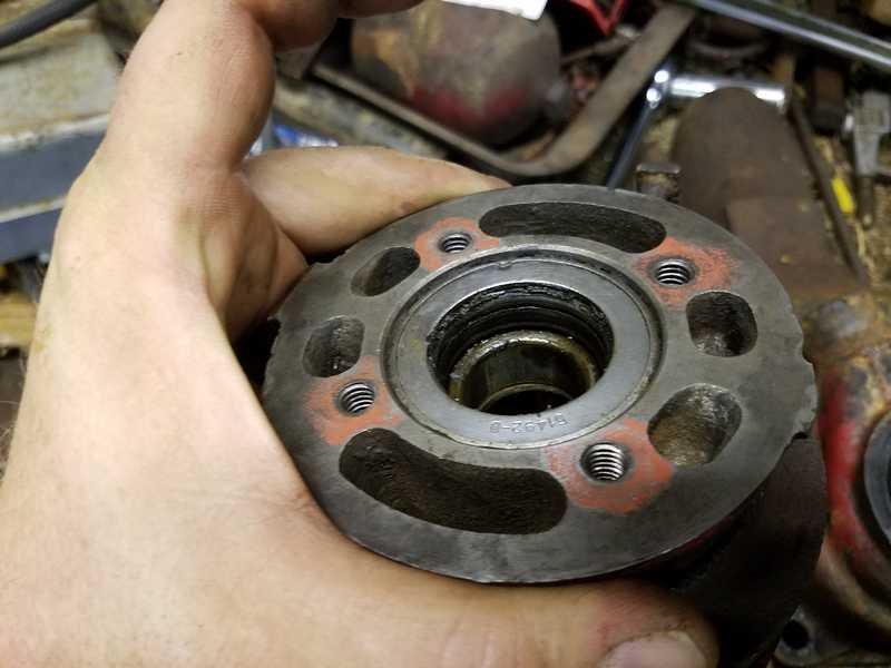

  10. Replaced the front and rear seal on the hub, replaced the packing and lubed but now the dang pump has a weird squeak.  What the heck??  Maybe the packing is too tight now?  Grrrrrrrr.  Thing is driving me nuts!!!!  On the plus side though, it's not leaking out of the water pump or the water jacket cover.  Not one drop!
  11. I was running out of reasons to tear the front end off the tractor and just like that.....viola, I had a reason.  :rolleyes: (Please tell me that we are going to add the face palm emoji I could use it right about now)  The bearings are tight and staying in but the front and rear seals are shot and the packing has packed its bags for retirement.  Just in case you weren't aware CNH offers all the parts to rebuild including the packing.  Had to break down and permatex the water jacket cover also.  Due to the pitting in the seal surface and the water jacket cover being warped slightly, it would not seal correctly.  I know they sell new covers but this one was solid and in fine shape otherwise and wearing its original yellow paint from where ever it came from.
