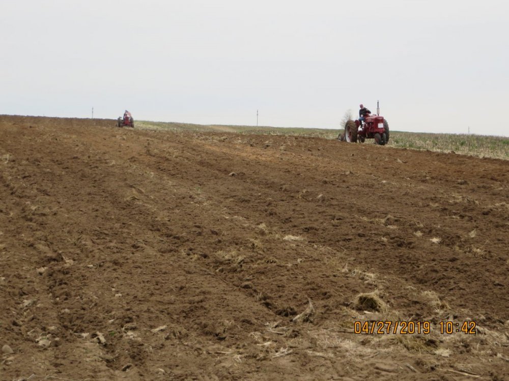

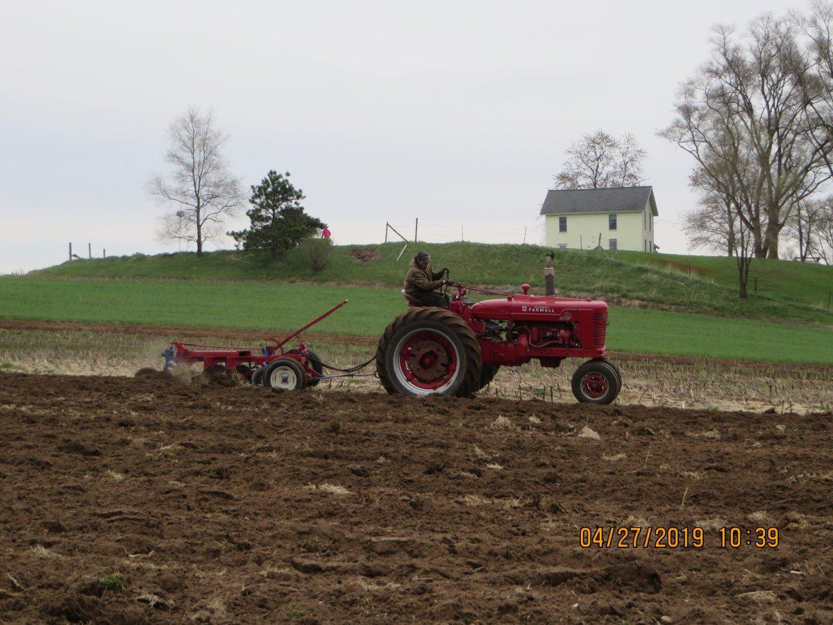

  5. Finally got a chance to get the H out and work on a few odds and ends that have been bugging me, fuel leak, plugs change over to D15Ys and the like.  Put the No. 8 plow on, 2-16's  and slammed it in the ground to see what it would do and most importantly, have some fun.  Well, it was fun but there are some problems to figure out as it was really struggling to pull that plow.  When it was near wot and would hit a tough spot it would pop, backfire and then catch up and go back to work.  I'm starting to think that my mag drive is 1 tooth off.  My next step is getting a timing light and confirm that it is off as it should show up with the light.  Everything else seems to be in good shape as it starts easy, idles smoothly and doesn't seem to run poorly otherwise.  Grrrr.....  Hoping the timing light shows some problem and that I just made a silly mistake.
