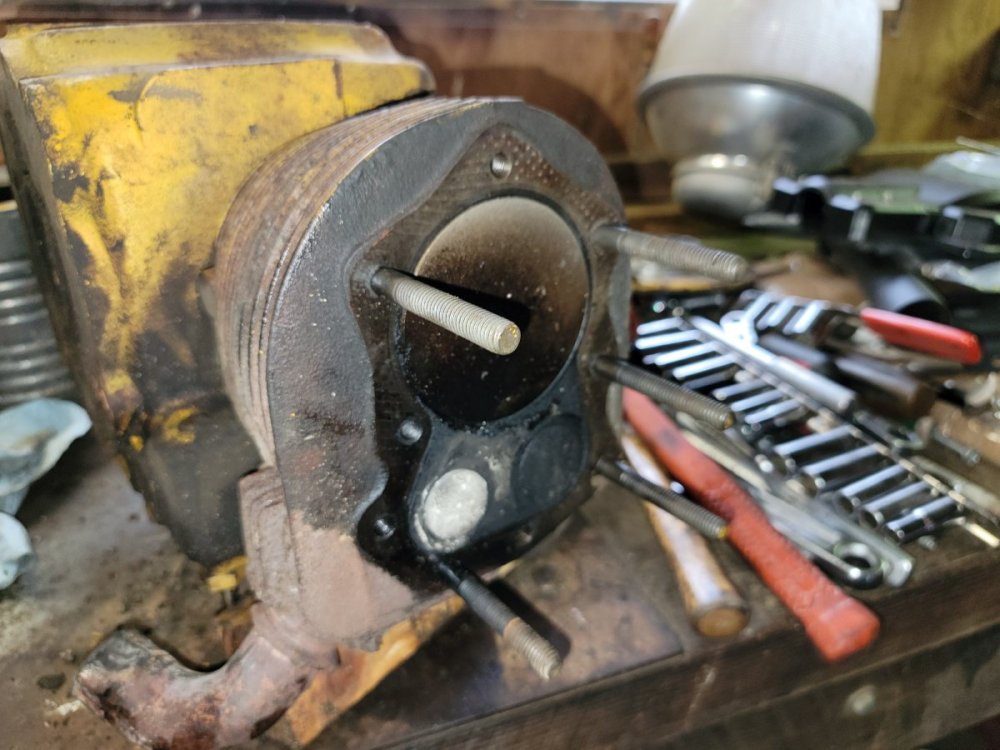

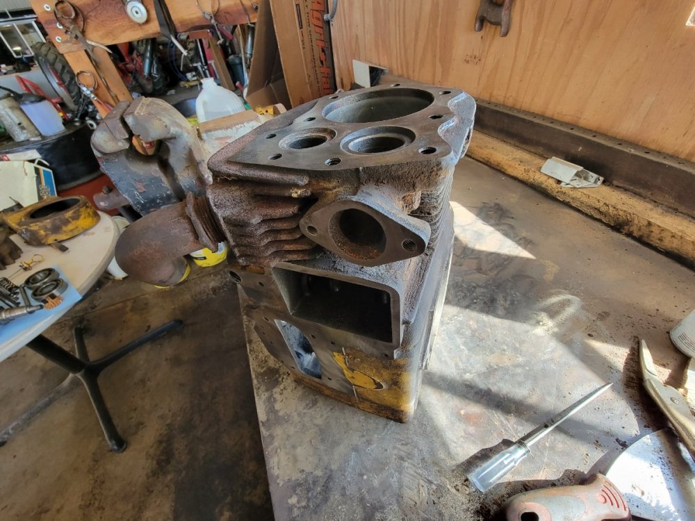

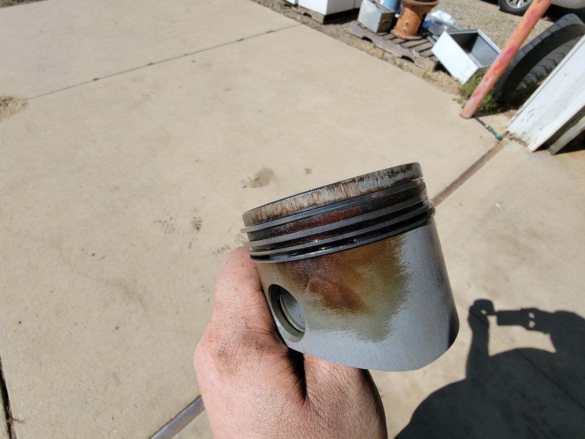

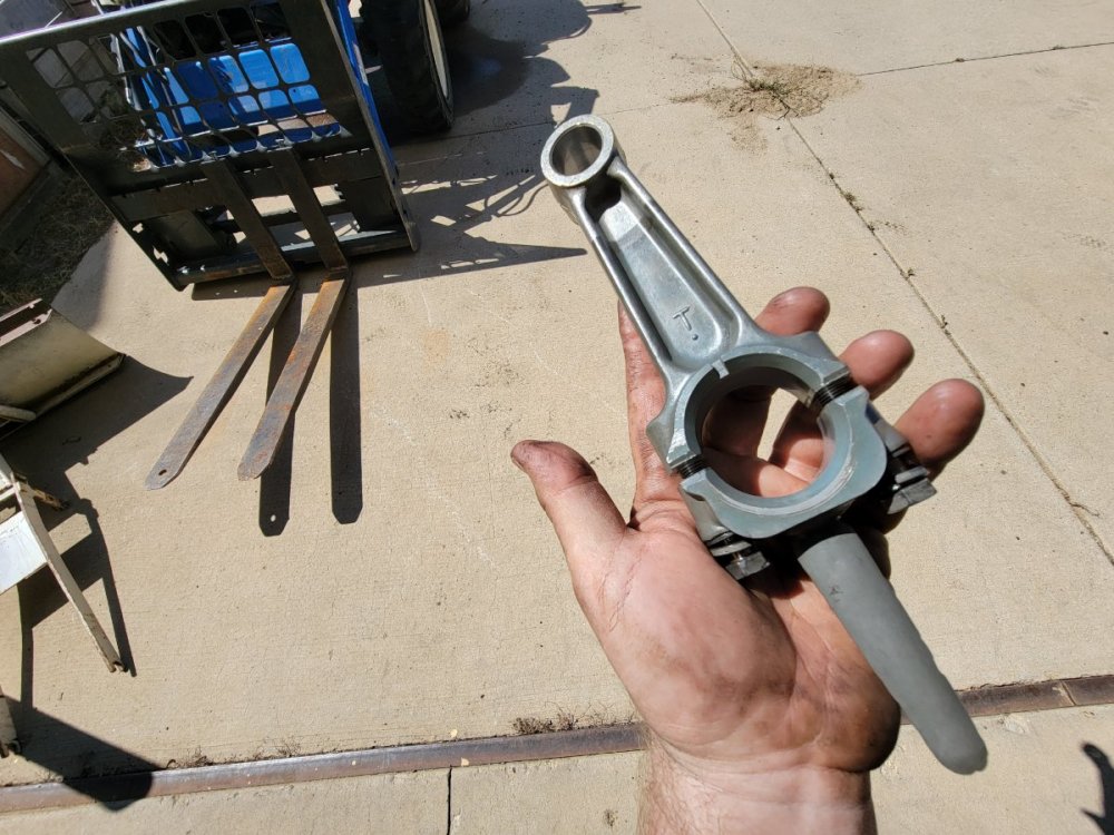

  12. Got the engine torn down this weekend. It was surprising how good the crank journal and con rod looked. The piston skirts were a little rough looking and possibly the source of the oil blow by but will have to measure to know what's going on. There is zero ridge in this block so I'm leaning towards a possible valve guide issues or the cylinder out of round. I'm also wondering if I should even bother replacing the main bearings. Here's a look at a few pictures I took this weekend.
