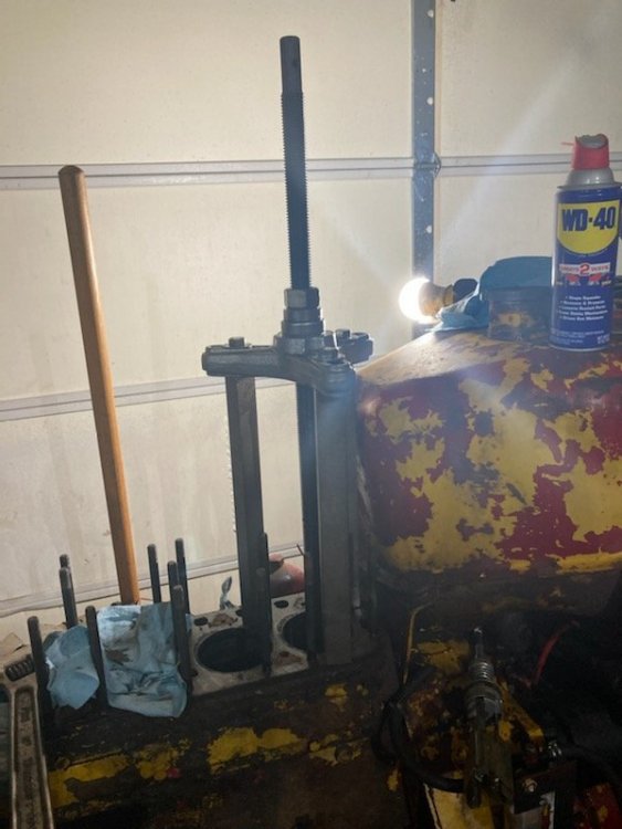

Well I finally dug deeper into several problems and have been fixing other things to get it mechanically sound before going down the paint road. T/A clutch was not releasing when clutching or pulling the T/A lever. Not totally sure I got it fixed but the disc was bonded to the pressure plate and flywheel. Several springs broke and use parts and a new disc later put back together. Also found the lower gear of the PTO loose and tightened that up. Still don't have it all adjusted yet. Pulled the head off and found gouges in the #4 sleeve and a chipped ring. Bearing were the best I have seen in a tractor I have pulled apart and may have been worked on in the recent past. The bore is standard and the wrist pins are the large size so it gets more involved when changing pistons. Pulled the sleeve and now am trying to get a good used sleeve before pulling the rest as they have minimal wear. Ordered new rings and gaskets but they have not come. The sleeve I found, the outer bore was too small. ID was ok at 3.563. Outer bore of new sleeve was 3.680 while what was in the tractor was 3.750. Not sure it was in the 300 bin at Worthington tractor. I wish I had hydraulic for my puller or a wrench with more leverage. I am hoping I do not need to go all out as this is mostly a puttering around type of tractor for play. It was just when it burned oil you sat in a cloud.
