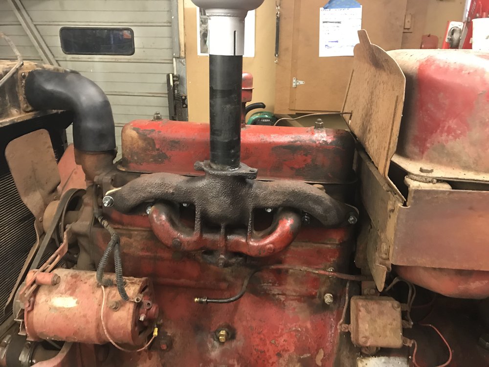

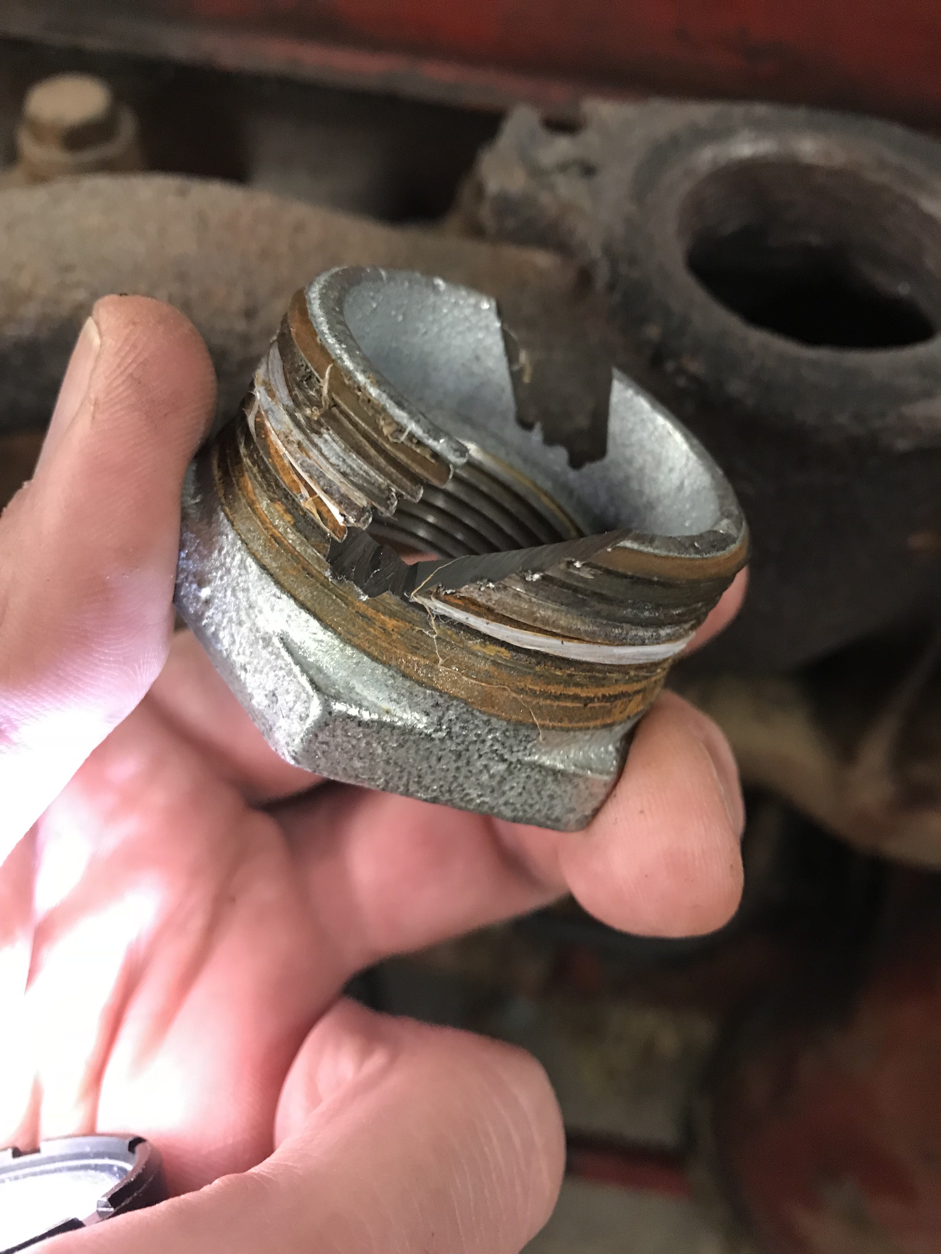

I guess I'm a little behind, so here's what we've accomplished: Manifold neck rethreaded and manifold reinstalled, with a pipe nipple and a muffler from Steiner. I returned the stanley muffler I got at Tractor Supply, but to be honest I couldn't tell much difference in the sound. The muffler from Steiner's looked better and has IH stamped in it. The carb was rebuilt as well, may still have to reset the float height. Last weekend we changed the oil and filter. I don't think the filter housing has been off since is was painted, and that's been a while. I decided to drain the transmission - got out 2/3 of a bucket of sludge / molasses / caramel like gunk. Poured in a half bucket of cheap oil and had my son make laps around the yard for half an hour, then drained it again and filled with slightly less cheap universal tractor hydraulic oil from TSC. Found a nice puddle under the end of the axle housing today. We replaced the oil pressure gauge and sensing line. We get about 20 psi max, and it drops off as the oil warms up. We also replaced the temp gauge, and somehow seem to have broken it. The needle never moved while we were running it Saturday, and the upper hose did get fairly warm while we were playing with the tractor. I made bushings for the steering column. It took a lot of the play out of the steering, but the threads on the steering wheel shaft are worn out and the nut won't grab. My son keeps pulling up on the steering wheel while mashing the brake pedals, and pulls the steering wheel off. The shaft is worn at the universal by the bell housing, I think if I can tighten it up there the steering will be nice. A few pictures, and maybe some questions at the end... Well, if you made it this far, I have a couple of questions - How difficult is it to change the axle seals? There is a grease fitting there, will greasing the axle help the leak? Any thoughts on how I may have damaged the temp gauge? My son says it worked when we put it in, I can't remember. The coolant was warm enough that the needle should have moved some Saturday, but all I saw was some vibration / jiggling. What should the oil pressure be? There is a fair amount of smoke from the breather on the valve cover, especially when climbing a hill at low throttle and the governor opens the throttle a bit. What does that indicate? worn valve guides? That's enough for now - thanks for looking!

Tried to fix the threads in the neck of the manifold tonight. Haven't been able to find a 1-1/2" NPT tap to borrow, so I tried making a thread chaser out of a fitting, and tapering off the threads on a piece of pipe. No luck. Then I noticed daylight through the bottom of the manifold. There is at least one pin hole in the exhaust passages, so I suppose I'll be pulling the manifold off tomorrow to see how bad it is. I've got a neighbor that's pretty handy with a torch and brazing rod, maybe it is patchable...

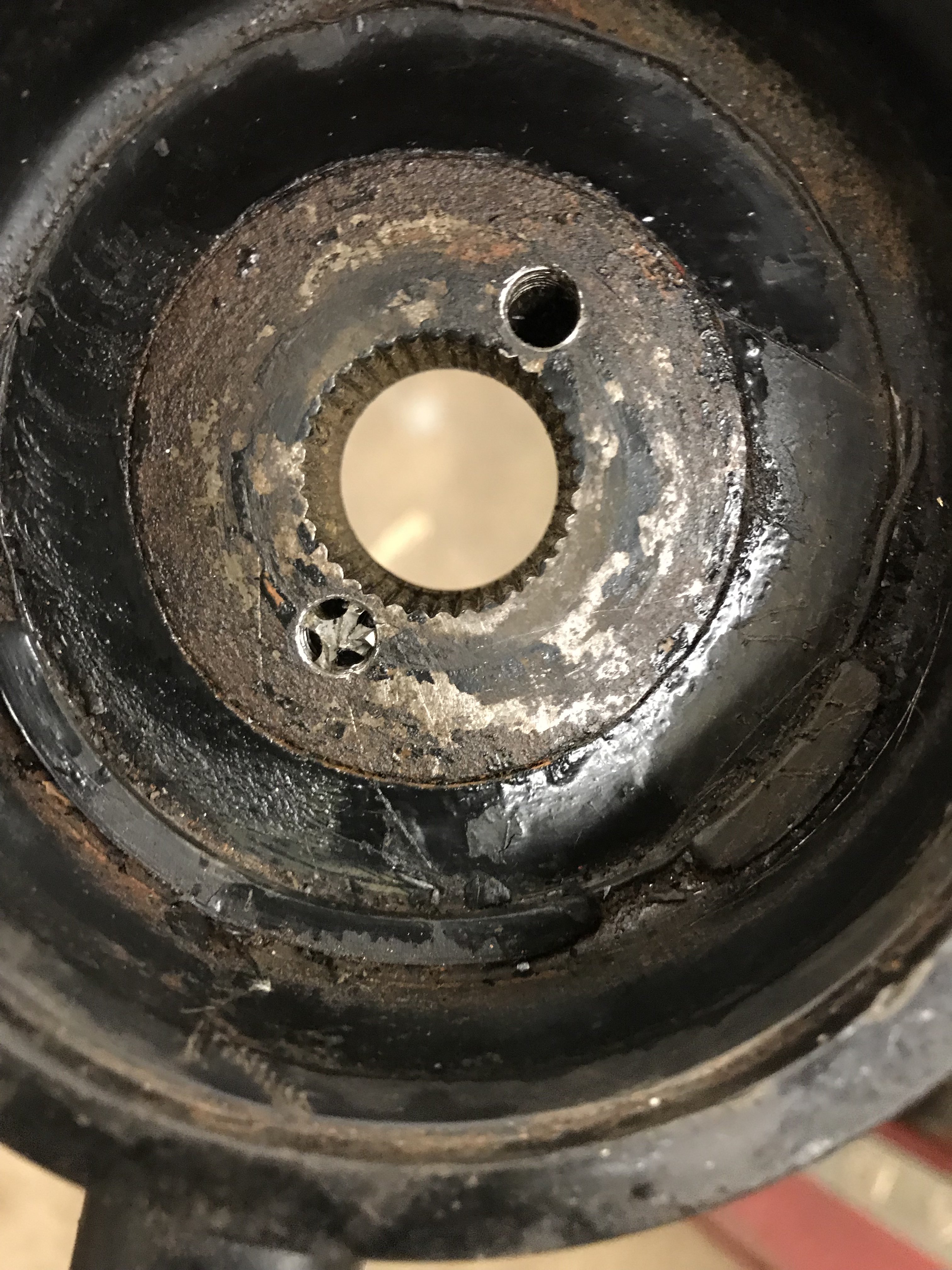

We've piddle at this a little bit over Christmas break. Today I wanted to get the steering shaft out of the column, so I could figure out what to do to take the wobble out of it. I want to get as much slop as I can out of the steering. Step 1, break a tap off in the puller hole in the steering wheel hub. The steering wheel is fairly nice, don't want to ruin it. I took the shaft loose at the u-joint below the dash and got it apart from below. I guess I'll leave the broken tap in the hole and hope I never have to pull the wheel again. I decided to drain the antifreeze. Finally got the drain tube between the front wheels flowing. The block drain was broken off flush, so I decided to teach my son how to deal with broken bolts. I drilled a 1/4" hole into the plug and showed him how to break off a bolt extractor. Then I showed him how to drill tiny holes around the broken extractor and finally wiggle it out. I got the drain plug drilled out to 1/2", still have a little bit of it to get out of the threads some how. After rinsing everything off with brake cleaner, I decided to try to heat the remaining metal from the drain plug with a micro torch (butane soldiering iron). Imagine my surprise when the brake clean floating on the water left in the block ignited. My son was stoked that he got to use a fire extinguisher on the burning brake cleaner on the lid of the bucket I had drained the antifreeze in. I was able to blow out the fire running down the block, but the lid of the bucket was too wide to blow it out. All in all, a normal day in the shop, right?
