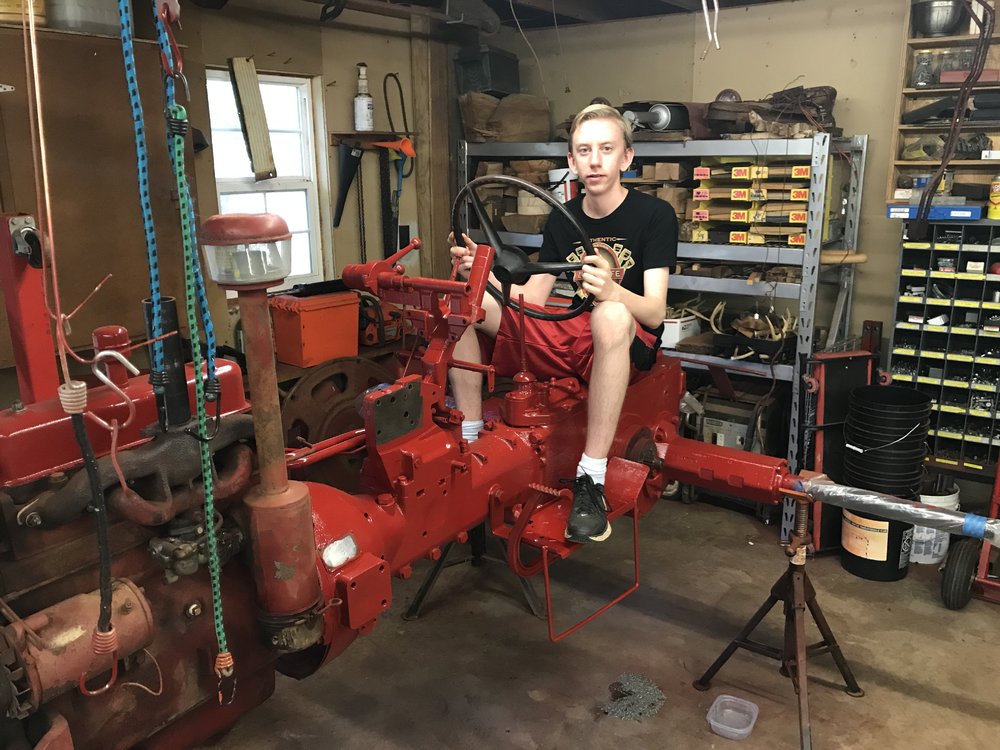

  1. Ha, Brody thinks the next step is to overhaul the engine. I hope y'all are prepared to answer a BUNCH of questions. Testing out the lights tonight.. Not the greatest pic, but I'm standing on the drawbar while Brody drives around the back yard.
  2. Been a while, better catch ya'll up.... Brody couldn't stand not working on it, so he did the hood and the rest of the sheet metal bit by bit, cleaned and repainted the badges as well. And most recently we installed the rare factory optional cheap LED lights so he could see to run a hay ride at our fall festival at church.

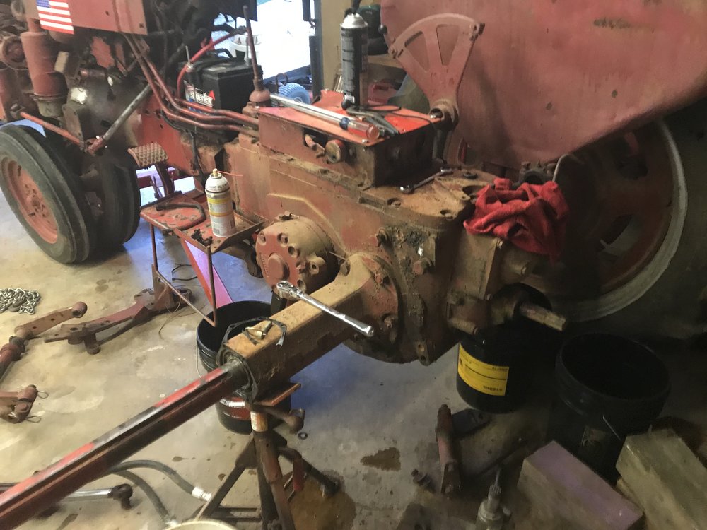

  11. I made some stands to bolt on while pulling the right rear axle. It felt stable enough pulling the left axle with the right rear wheel and tire still attached and blocking under the rear housing, but without the tire and wheel it looked sketchy to me.
  12. Brief update... The steering column is stripped down as far as I want to go. Needs a little more wire brushing to be ready for primer. Tonight we got the right axle on a stand and hit the wheel and center off of the axle. I hope to get a local sandblasted to clean up the wheel centers, weights, hitch parts, and some of the sheet metal, and hand clean the chassis from the tail end to the bell housing. We will get that primed and painted, then address the engine and front pedestal.

  14. New bearings and seals installed and the axle is back on the tractor. Seems like this is getting out of hand, I had to pull the gas tank to disconnect the hydraulic lines to get the cover off of the transmission.
  15. Significant destruction has occurred today. Inner bearing is in perfect condition, axle may have SLIGHT wear at outer bearing. Outer bearing has a lot of play in the balls. I’ll mike the axle after lunch and decide if any machine work is in order or not.
