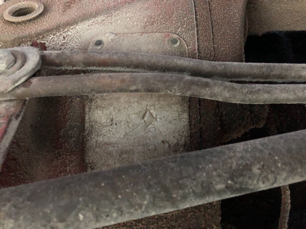

  3. I bet your serial number suffix is cc for heavy tillage third gear.  Not sure either when the factory installed the 560 upgrades, but an old time IH parts guy told me about the factory program to install the upgrade parts in a tent set up at dealerships.  A diamond shape stamped on the serial tag indicates the tractor went through the upgrade program.  My 1959 560 serial 17,XXX s z cc has the diamond stamp.  I am the second owner (since 1972) so I can’t ask the original owner about it any more and my parts guy friend died a few years ago.  I asked him what all was in the upgrade and he said it was a whole wooden crate full of parts but didn’t know what all was in it.  I really miss being able to visit with him…..his blood was IH red!
